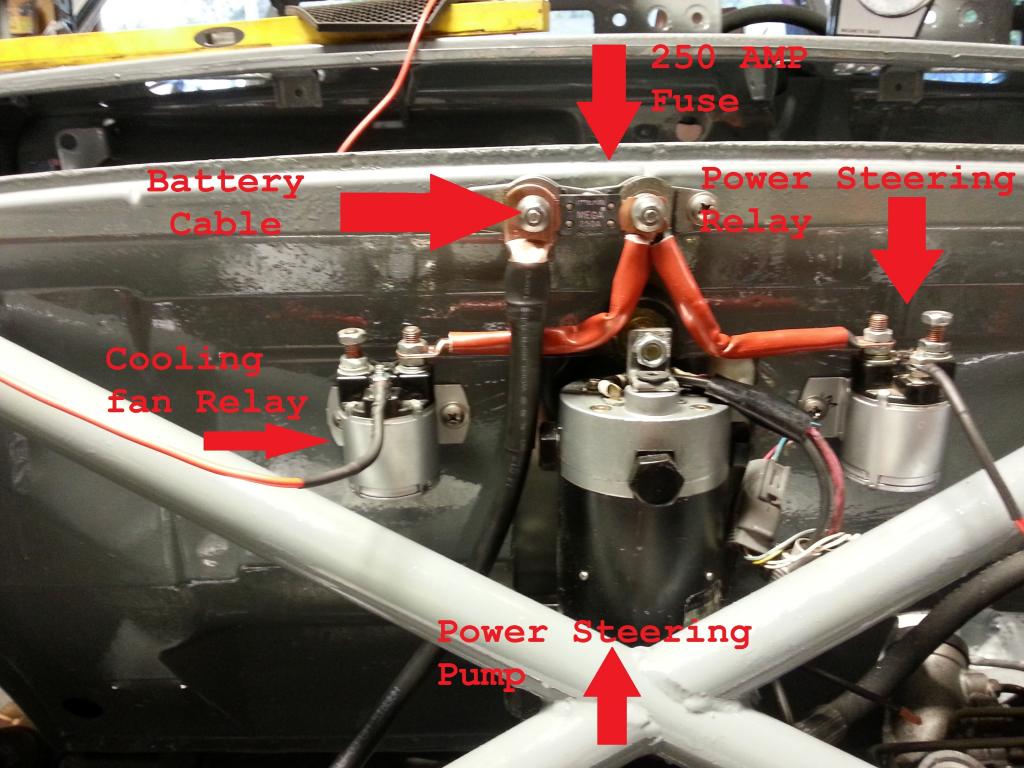

Started wiring up the fans and P/S pump. Using 1 gauge battery cable and 10 gauge for the fans and last 9 gage for the P/S pump. The 250 amp fuse is a bit too big but I found a 100 amp to install later. Those relays are good for 80 amps or so.
(IMG:http://www.914world.com/bbs2/uploads_offsite/i60.photobucket.com-3782-1395373763.1.jpg)

drive-ability   Started wiring up the fans and P/S pump. Using 1 g...   Mar 20 2014, 09:49 PM
Jeff Hail   Started wiring up the fans and P/S pump. Using 1 ...   Mar 20 2014, 11:38 PM
