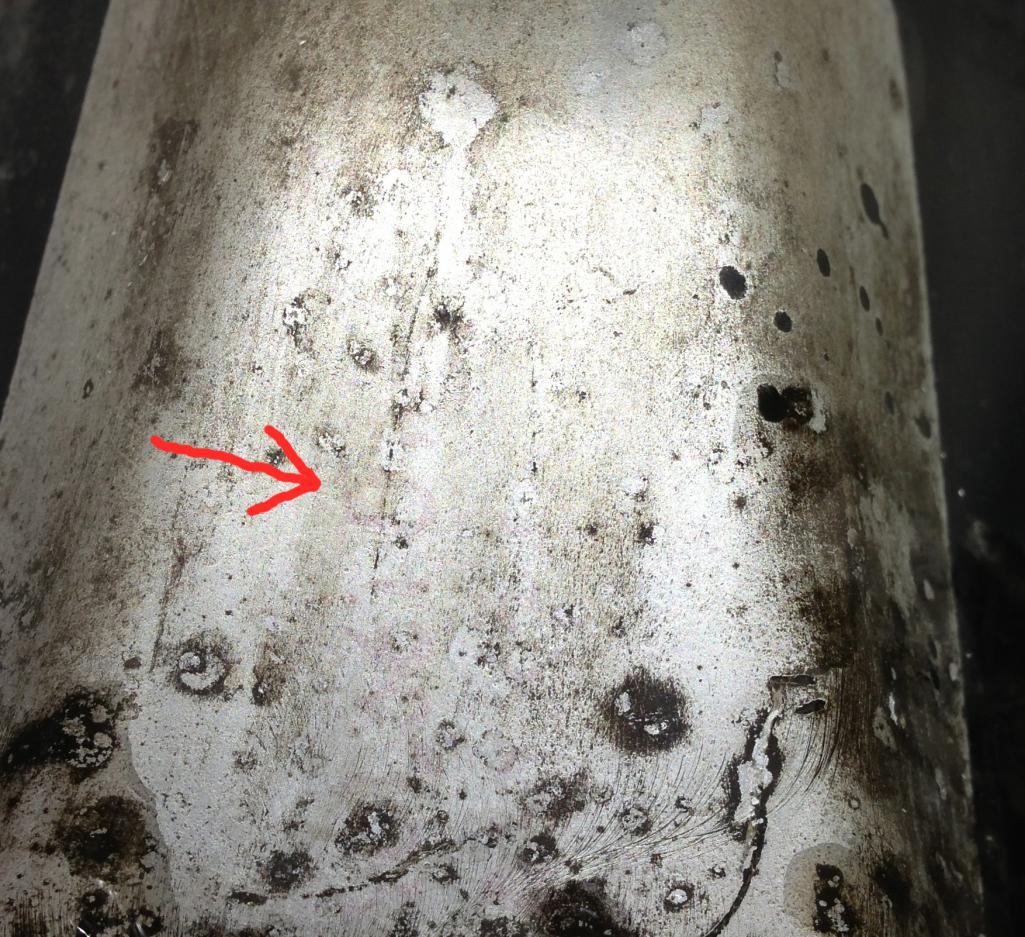

After educating myself a little, I believe I have 3 real Fuchs 6x15 Flats and 1 Questionable "Deep Six"
Note that it does have the "heart" but its hard to see in this picture
Any thoughts on Real or Reproduction here?
I'm hoping to get another Flat 6x15 and have a set that I can use on my car at some point later on down the road.

I cleaned the wheel in question up a little and found some very faint remains of what appears to be a purple stamp. I don't think it's a 7R, doesn't appear to be wide enough. Is there such thing as a 6R? or did they just use a standard deep six on the front of the 911r?

Eric_Shea   Need to see more on the deep 6. Inside the backsi...   Mar 22 2014, 09:46 AM
wndsnd   Hearts are best seen from the back side as well. ...   Mar 22 2014, 09:57 AM
ezbngreen914   I can't make out any markings on the inside ...   Mar 22 2014, 10:26 AM
mepstein   I can't make out any markings on the inside...   Mar 22 2014, 12:05 PM
Eric_Shea   Not all deep sixes have hearts. Hard to say and I...   Mar 22 2014, 10:43 AM
Eric_Shea   I just noticed it was a larger image. I clicked o...   Mar 22 2014, 10:46 AM
sixnotfour   7 /67 is the manufacture date 7 month 67 year mak...   Mar 22 2014, 12:10 PM
Eric_Shea   7 /67 is the manufacture date 7 month 67 year ma...   Mar 22 2014, 02:39 PM
BIGKAT_83   I saw that ad 10mins after it was posted on the Cr...   Mar 22 2014, 12:31 PM
tumamilhem   Very interested in this. How do you tell real Fuch...   Mar 22 2014, 12:37 PM
mepstein   Very interested in this. How do you tell real Fuc...   Mar 22 2014, 12:41 PM
tumamilhem   Where will this triangle be located? And what is t...   Mar 22 2014, 12:55 PM
sixnotfour   On a 67 Fuchs it was an ink stamp, A wheel in the ...   Mar 22 2014, 12:58 PM
mepstein   fuchs heart   Mar 22 2014, 01:00 PM
carr914   I can't make out any markings on the inside...   Mar 22 2014, 01:02 PM
tumamilhem   Ah! So only one opening would have it?   Mar 22 2014, 01:03 PM
wndsnd   Heart is at the valve stem   Mar 22 2014, 02:30 PM
tumamilhem   Heart is at the valve stem Nice. Thanks for the ...   Mar 22 2014, 02:41 PM
mepstein   I've seen fake Fuchs but not fake Fuchs with h...   Mar 22 2014, 03:01 PM
sixnotfour   I have seen people weld on Hearts...   Mar 22 2014, 03:05 PM
mepstein   I have seen people weld on Hearts... As prices ...   Mar 22 2014, 03:15 PM
ezbngreen914   Thanks for the input everyone! :beer2: I...   Mar 22 2014, 06:33 PM
ezbngreen914   I cleaned the wheel in question up a little and ...   Mar 23 2014, 10:20 AM
Eric_Shea   Thar she blows! Can you read any of it? That...   Mar 23 2014, 12:34 PM
