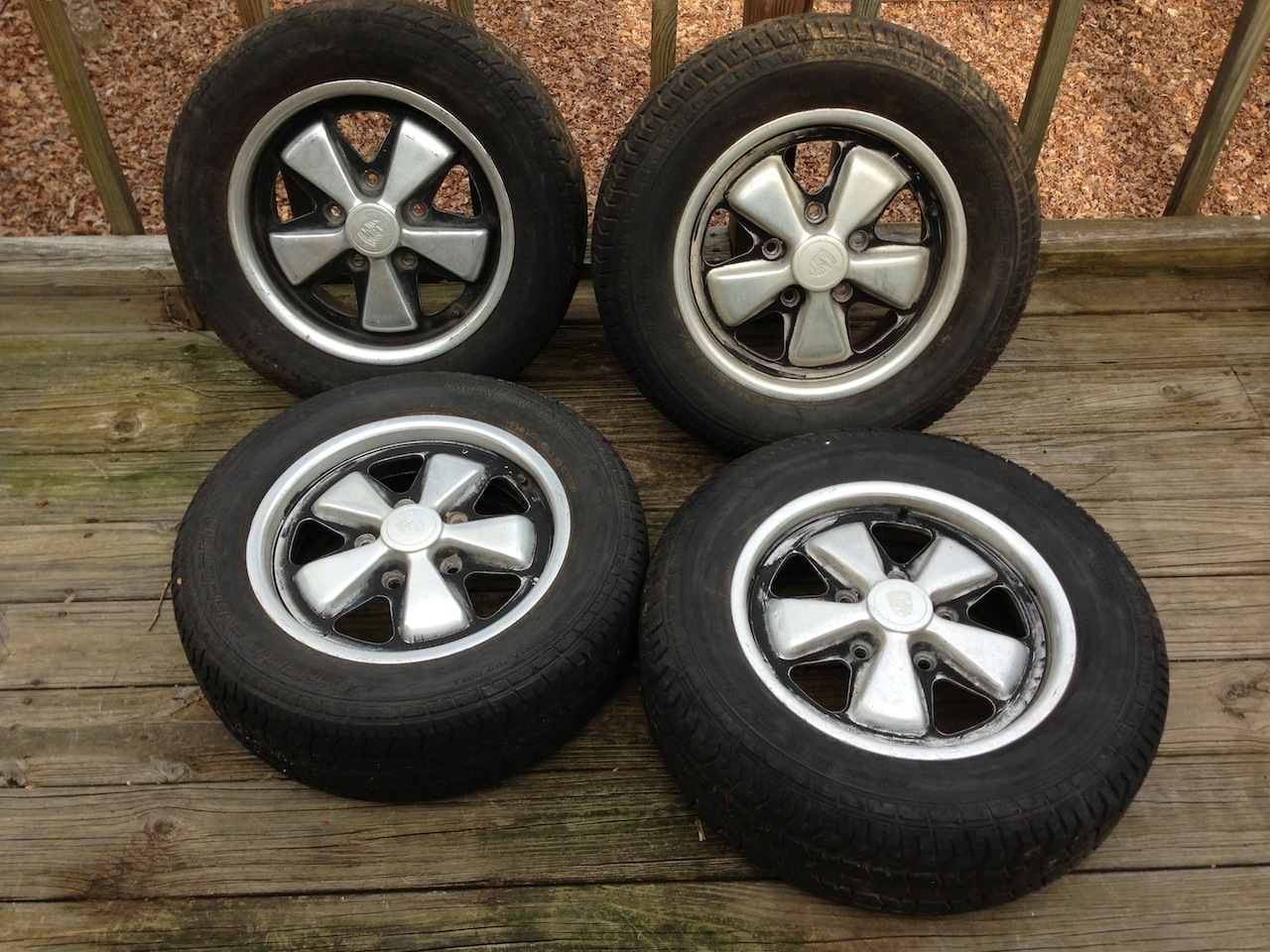

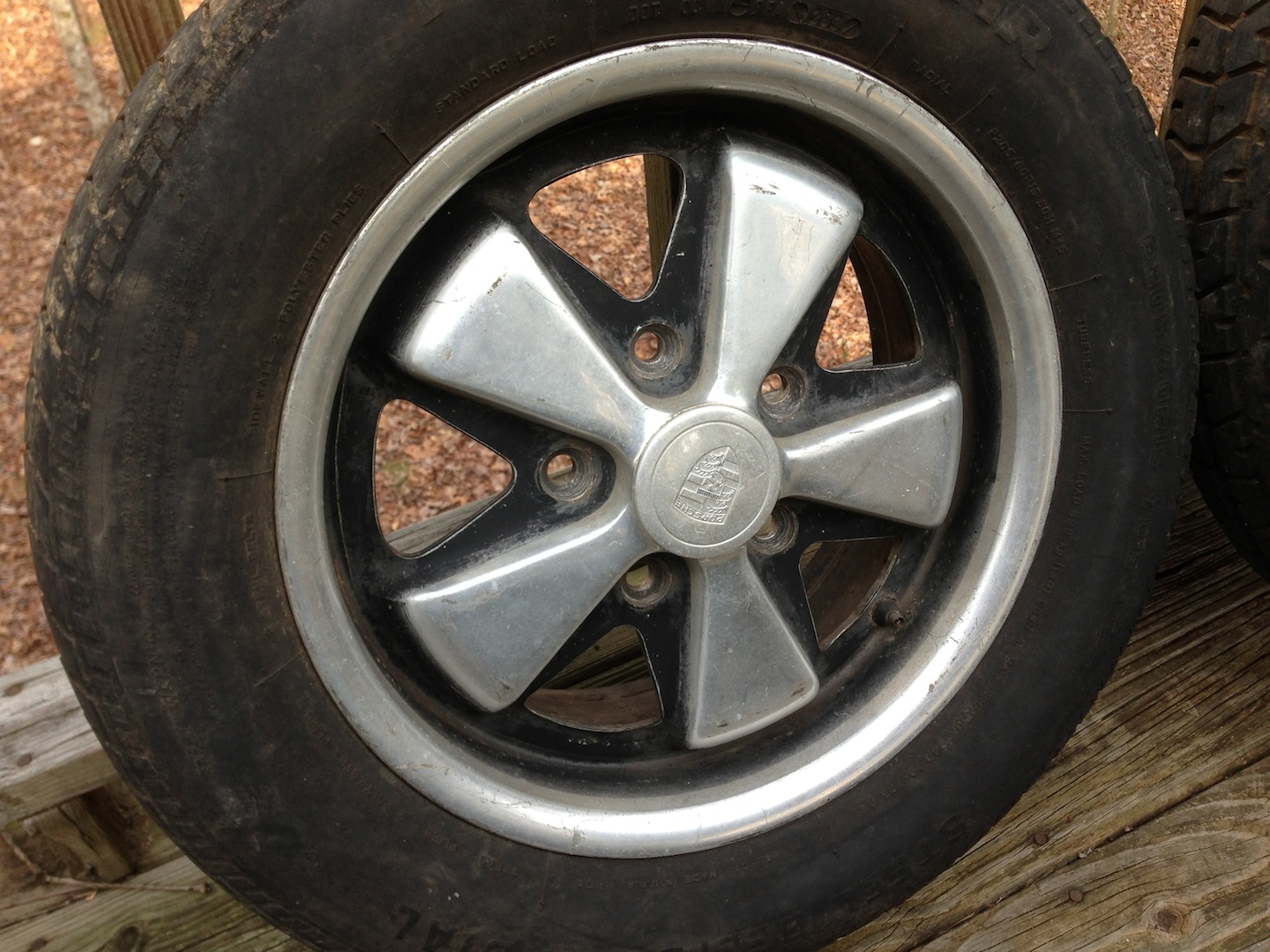

After educating myself a little, I believe I have 3 real Fuchs 6x15 Flats and 1 Questionable "Deep Six"
Note that it does have the "heart" but its hard to see in this picture
Any thoughts on Real or Reproduction here?
I'm hoping to get another Flat 6x15 and have a set that I can use on my car at some point later on down the road.

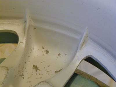

Need to see more on the deep 6.
Inside the backside of the paddles... any markings?
wndsnd
Hearts are best seen from the back side as well.

I can't make out any markings on the inside of the paddles. Its still kind of dirty but I'm pretty sure there is nothing there.

Not all deep sixes have hearts.

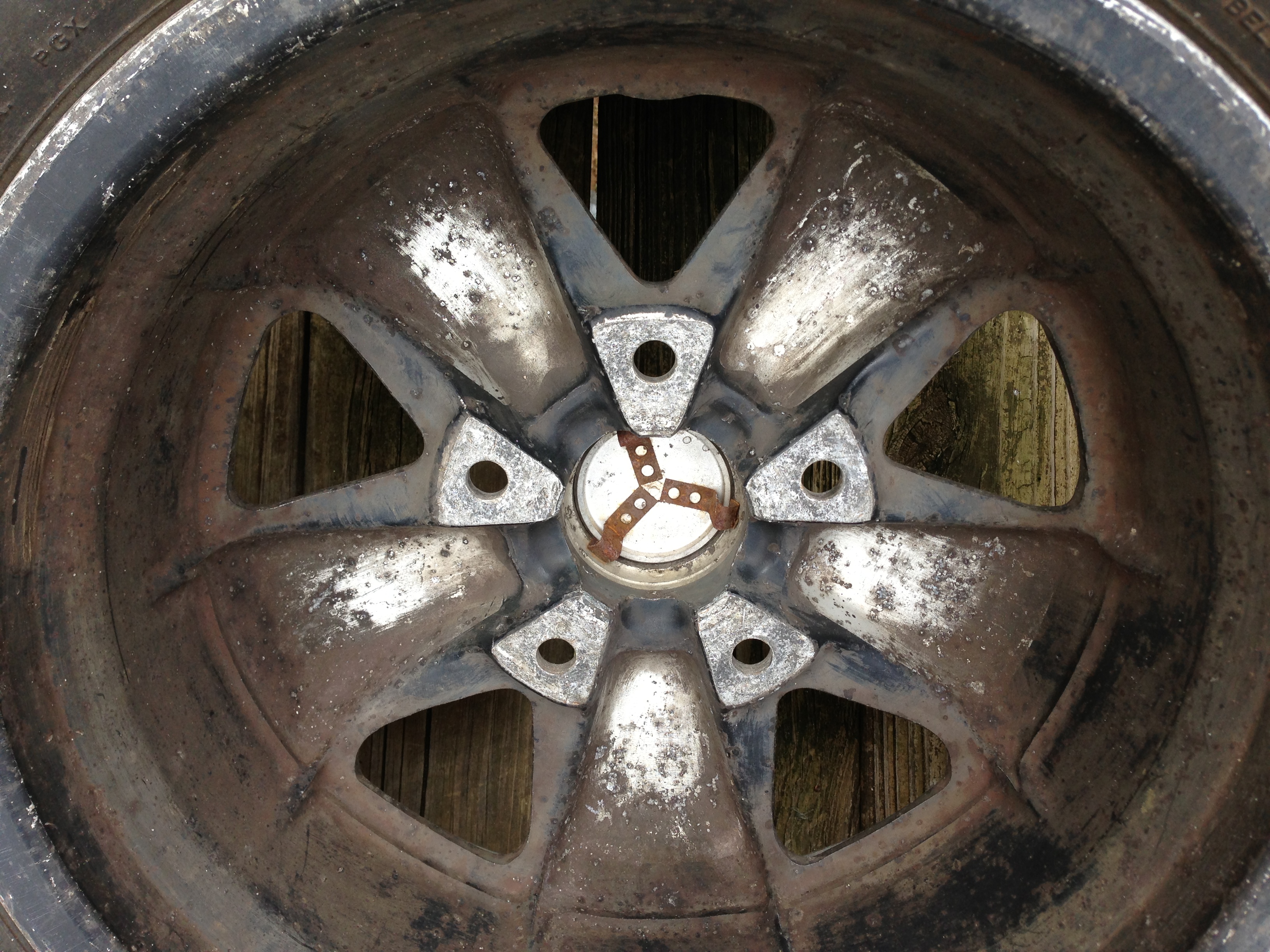

Hard to say and I'm not the uber educated wheel guy. The paint line looks correct, hard to imagine a fakes going to that extent. You'll want to wash it up and look for a triangle with a P in it and a little Fox (Fuchs) head stamped in it. They usually have a 6J x 15 there as well and, if you can clean it up, there may be in ink stamp in the anodized aluminum with remnants of a part number.

I just noticed it was a larger image. I clicked on it and got a really good close up of the back of the paddles. I'd vote Fakes right now...
QUOTE(ezbngreen914 @ Mar 22 2014, 12:26 PM) *

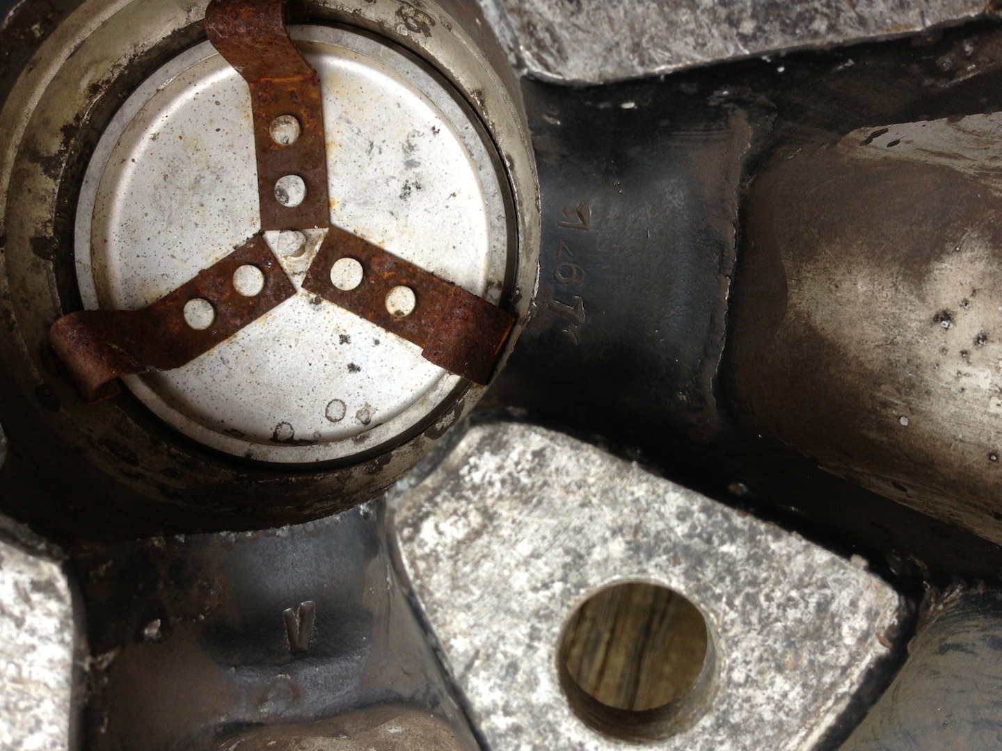

what is the stamp on the paddle at 6 o'clock?
sixnotfour
7 /67 is the manufacture date 7 month 67 year
make sure its not a 7R wheel
Real Fuch sell it on 911S registry
Identified by the deep rim upstand, about 42mm, and the web on the back face and no hump

On a 67 Fuchs it was an ink stamp, A wheel in the condition pictured above I am pretty sure it is long gone..
fuchs heart
carr914

wndsnd
Heart is at the valve stem

Go with what Jeff says here... He's seen many more of these wheels than I have. The paint line looked weird to me where it meets the center but, again, there's a lot of work put into it if it were a fake. So... Looks like this is your lucky day.

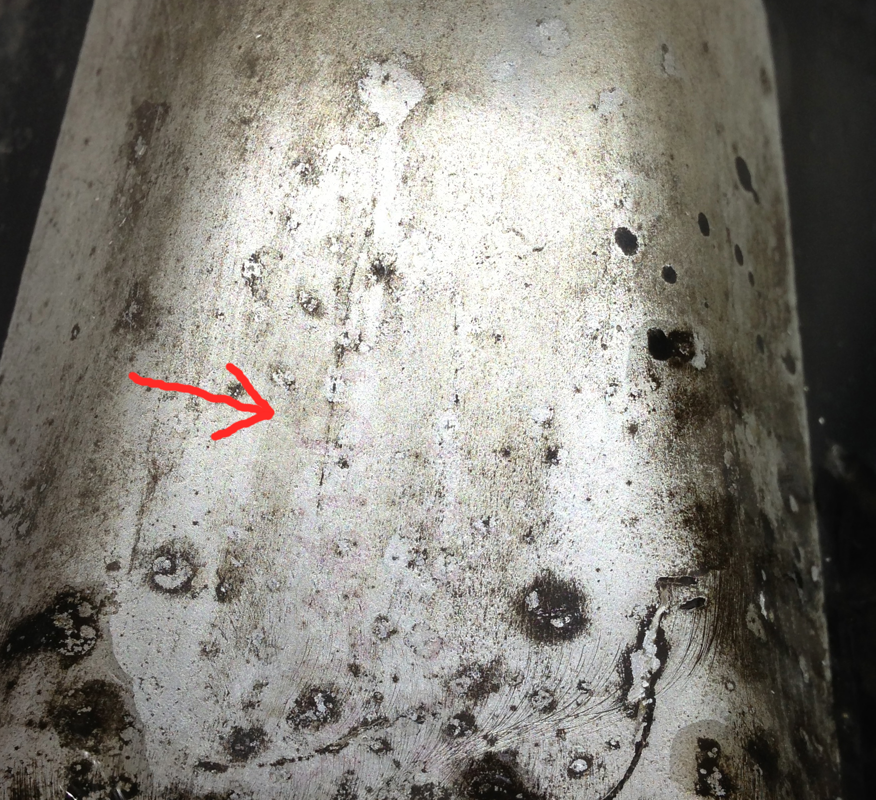

I cleaned the wheel in question up a little and found some very faint remains of what appears to be a purple stamp. I don't think it's a 7R, doesn't appear to be wide enough. Is there such thing as a 6R? or did they just use a standard deep six on the front of the 911r?
Eric_Shea
Thar she blows! Can you read any of it? That's probably good for $5-600.00 bucks.
