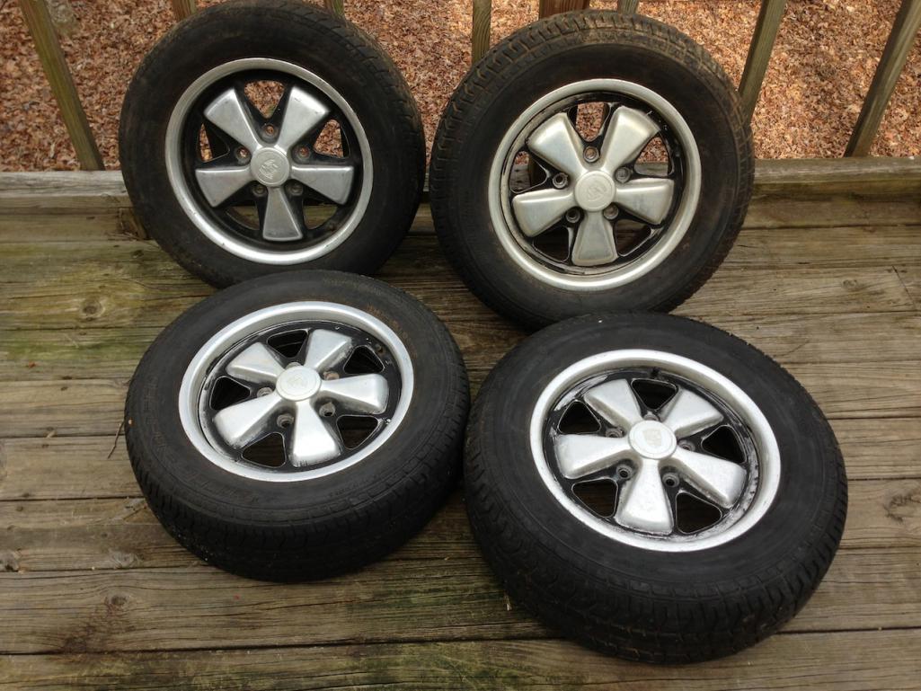

I missed out on scoring a 2.0 flat six with carbs and trans (out of a 67 911 targa) that a guy was selling for $1,500.00 but got some wheels as a consolation prize. The seller owned a body shop and said that the car was just too rusty to save. I'm trying not to think about what his idea of too rusty might have been.
Anyway, when I got to the shop the engine was sitting there and as I approached with interest the guy that had beaten me there quickly closed the deal. He seemed like a man of means and knowledge so the engine probably ended up in good hands.
I didn't leave empty handed though.

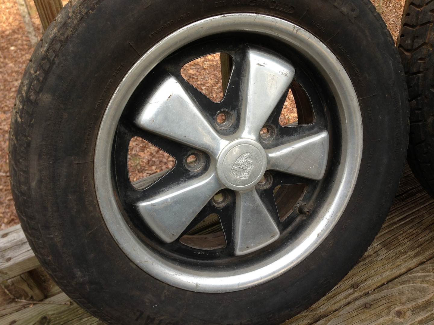

After educating myself a little, I believe I have 3 real Fuchs 6x15 Flats and 1 Questionable "Deep Six"
Note that it does have the "heart" but its hard to see in this picture
Any thoughts on Real or Reproduction here?
I'm hoping to get another Flat 6x15 and have a set that I can use on my car at some point later on down the road.

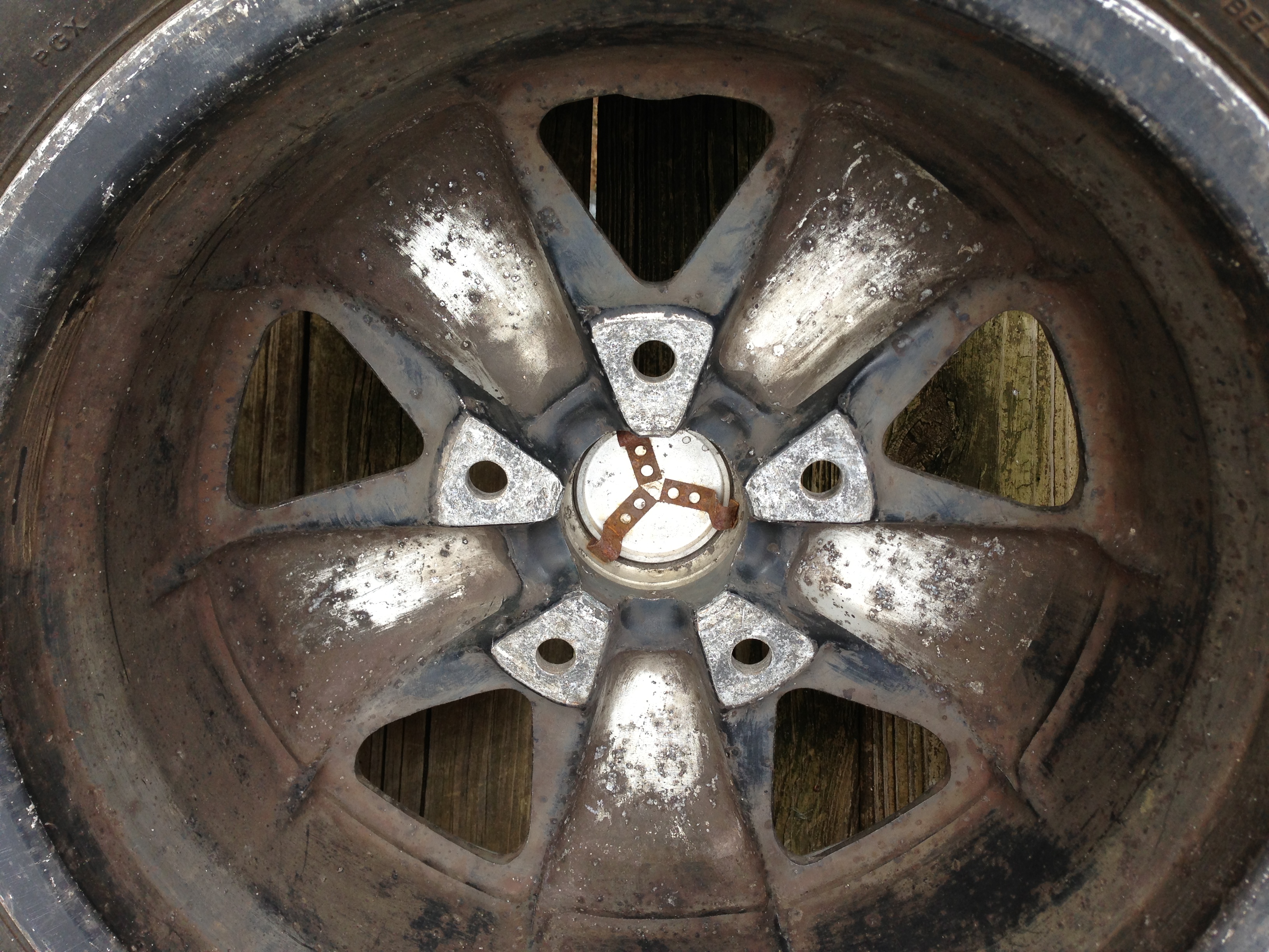

Need to see more on the deep 6.
Inside the backside of the paddles... any markings?

I can't make out any markings on the inside of the paddles. Its still kind of dirty but I'm pretty sure there is nothing there.

I just noticed it was a larger image. I clicked on it and got a really good close up of the back of the paddles. I'd vote Fakes right now...

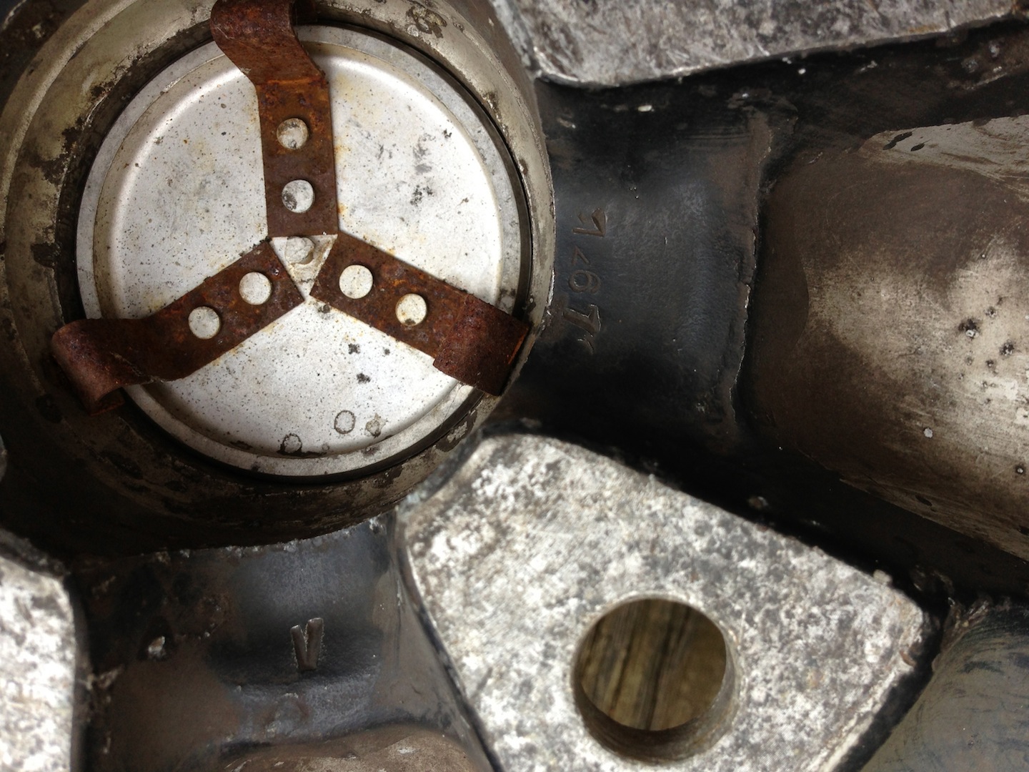

post Mar 22 2014, 12:05 PM
914-6 GT in waiting
Posts: 20,662
Joined: 19-September 09
Member No.: 10,825
QUOTE(ezbngreen914 @ Mar 22 2014, 12:26 PM) *
what is the stamp on the paddle at 6 o'clock?
sixnotfour
post Mar 22 2014, 12:10 PM
Posts: 11,213
Joined: 12-September 04
Member No.: 2,744
7 /67 is the manufacture date 7 month 67 year
make sure its not a 7R wheel
Real Fuch sell it on 911S registry

post Mar 22 2014, 01:02 PM
Racer from Birth
Posts: 132,449
Joined: 2-February 04
From: Tampa,FL
Member No.: 1,623
Look at 12 O'Clock (IMG:style_emoticons/default/icon12.gif) (IMG:style_emoticons/default/wub.gif)

wndsnd
post Mar 22 2014, 02:30 PM
You wanted a horse, but got a goat. Nobody wants a goat....
Posts: 2,861
Joined: 12-February 12
From: North Shore, MA
Member No.: 14,124
Heart is at the valve stem
Eric_Shea
post Mar 22 2014, 02:39 PM
PMB Performance
Posts: 19,304
Joined: 3-September 03
From: Salt Lake City, UT
Member No.: 1,110
QUOTE(sixnotfour @ Mar 22 2014, 12:10 PM) *
Identified by the deep rim upstand, about 42mm, and the web on the back face and no hump
http://www.early911.co.uk/assets/images/deep-6-web-2-400.jpg
Go with what Jeff says here... He's seen many more of these wheels than I have. The paint line looked weird to me where it meets the center but, again, there's a lot of work put into it if it were a fake. So... Looks like this is your lucky day.

post Mar 22 2014, 03:01 PM
914-6 GT in waiting
Posts: 20,662
Member No.: 10,825
I've seen fake Fuchs but not fake Fuchs with hearts. Not to say they might not exist but certainly not common. Hearts go for GOOD money
