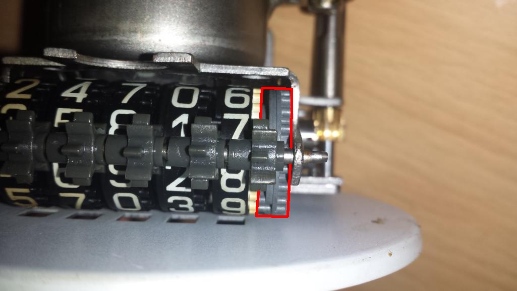

This is the gear

QUOTE(euro911 @ Feb 7 2014, 12:02 AM) *
This is the gear
That's the one that is slipping.
I just fixed mine today. I taped the rollers together securely. Pulled the outer gear by prying under the spacer carefully. My solution was to pound the end of the shaft to oval it out a little bit. I used the thin side of a bodywork dolly as an anvil and a few hammer taps to re-seat it in the inner gear but it works nice.
