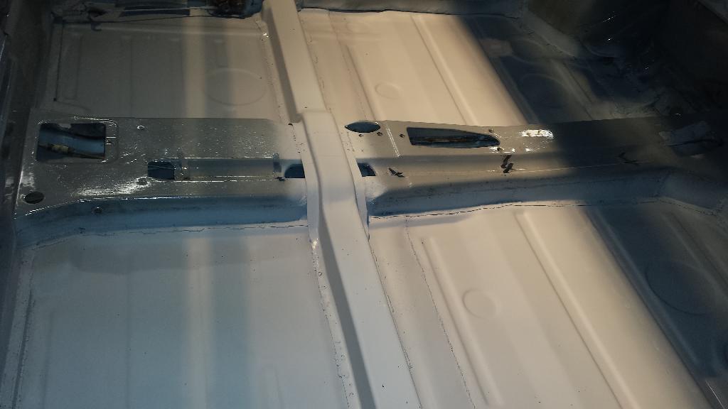

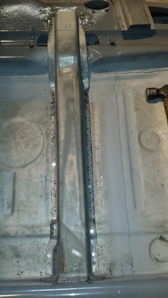

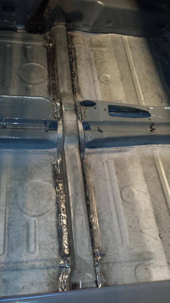

This evening brings the end of a very productive weekend. Saturday morning I went to work first thing test fitting and drilling for rosette welds. The RD cross member comes in two segments. You have to bend the out-board ends out which is simple enough. I was going to lap the left piece over the top of the right piece were they come together over the tunnel (about 2" of over-lap). But I found that the floor pan needed to be pushed up to be flush with the cross member flanges. That extra 1/16" created if I lapped wouldn't be helpful. So I trimmed the left piece end over the tunnel. I used rosette welds along the pan, on top of the tunnel and where the "ears" join the longs. I also seam welded those areas (every 4" on the pans). The net result was a really solid feeling floor pan with zero give when you stand in the compartment. I finished up this morning and primed the pans and cross member. Then I went head first into the right front fender...
