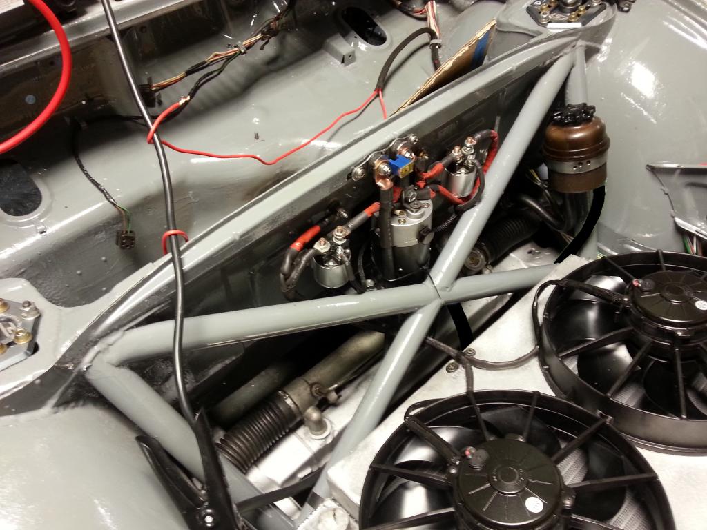

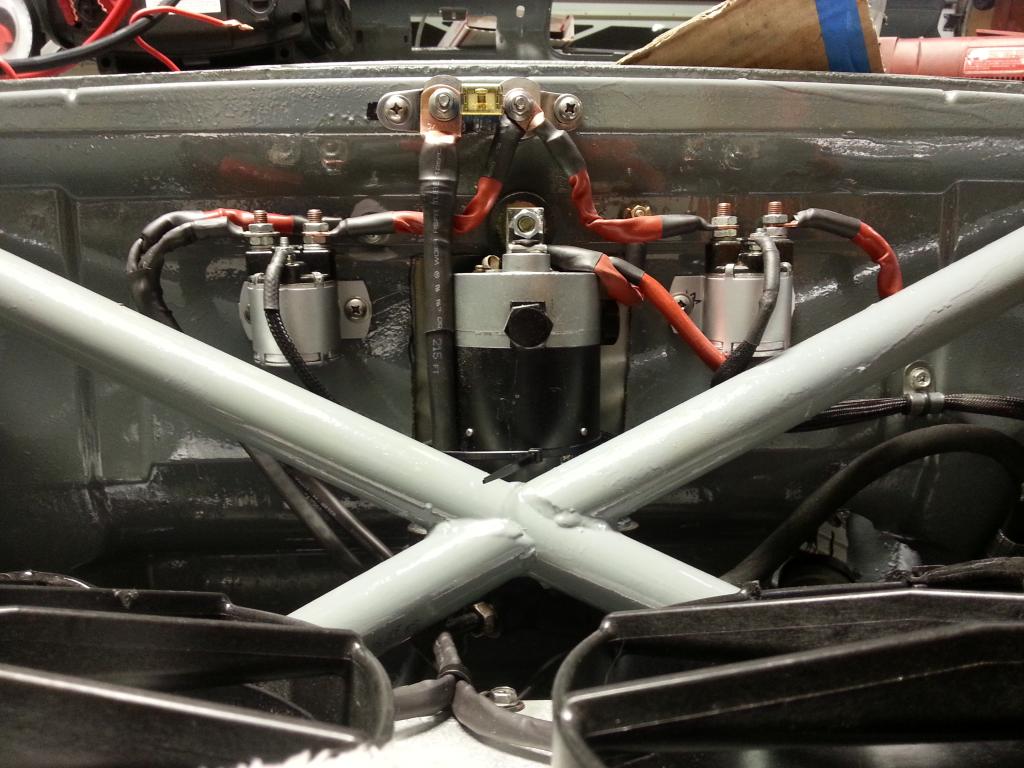

drive-ability   Started wiring up the fans and P/S pump. Using 1 g...   Mar 20 2014, 09:49 PM
Jeff Hail   Started wiring up the fans and P/S pump. Using 1 ...   Mar 20 2014, 11:38 PM
drive-ability   http://www.914world.com/bbs2/uploads_offsite/i60.p...   Mar 24 2014, 01:09 AM
drive-ability   I found an extra Mercedes fan resistor set laying ...   Mar 25 2014, 11:45 PM
drive-ability   Question, My fans and electric power steering p...   Mar 25 2014, 11:54 PM
speed metal army   I would fuse them separately for sure. You want to...   Mar 26 2014, 12:02 AM
drive-ability   yes that's a good point ! I still have...   Mar 27 2014, 12:30 AM
drive-ability   Installed some fuses to the fans & power steer...   Mar 28 2014, 06:11 PM
