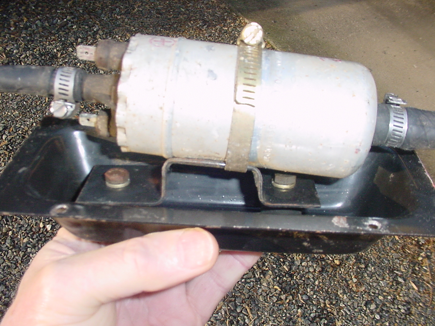

Can someone dig up some pics of where the stock 1975 fuel pump sat. I know it was in the front behind the little black metal door in the front trunk and underneath the tank.
What fuel pump part number was used for these?
Does anyone have pics of how/where the pump was mounted?
Where the fuel lines ran to and from the tank and to the fuel lines through the bulk head.
How it looked from the little access door in the the front trunk, etc.

pump #s 0580463010 or 043906091. what you can't see well are the 2 rubber isolators/mounts under the clamping bracket.

Curious about the part #s. They look the same, what is the difference? the 043... unit is about $113 on amazon, but Amazon says the FIT is wrong and it won't FIT on the 75 914. Not that I believe Amazon, but do you know the diff, cause at $113 I will buy it.
