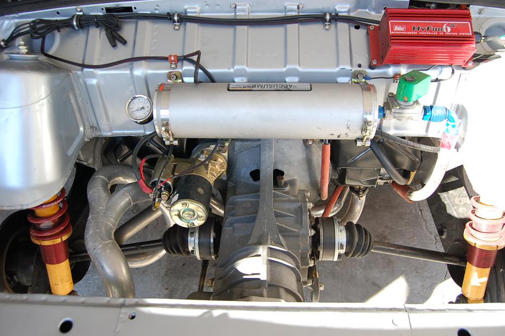

Here is one trick that makes the job easier...
After the event in Medford I used locktite on the outboard bolts and (lucky me) Mark wired the inboard ones. Probably a good idea as you don't want a CV coming off during a hill climb. Although I believe the posters that said new washers and correct torque will elimate bolts coming out. |
