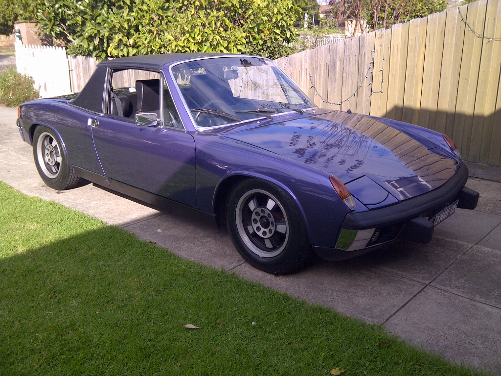

I've got a set of Riviera's on my teener, and it's currently on 165 r 15's that are probably past their use by date.
heaps of room in the front, but only about 2cm worth at the rear ( and less on one side than the other ) .
The rear guard lips seems to be trimmed ( the metal has a scalloped section at the top, but im not sure if this is stok or not ).
Any advice on what i should be look at size wise ??
Maybe a trip to the tyre shop for a test fit exercise .....
