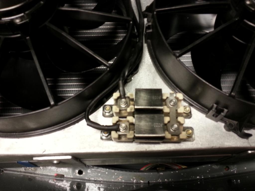

I found an extra Mercedes fan resistor set laying around the garage. Its a quality unit and will use it as a low speed cooling fan option. I going to mount it on the other side of the fan shroud. It will likely need some cooling and I would hate to place my hand on it when its doing its thing.
(IMG:http://www.914world.com/bbs2/uploads_offsite/i60.photobucket.com-3782-1395812744.1.jpg)
