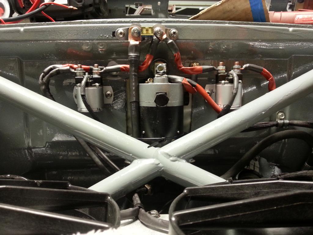

Question,
My fans and electric power steering pump are wired as seen in the previous pictures have a main fuse (for now 100 amp) should I fuse the fans and pump using individual fuses ? For example, keep the 100 amp main and use a fuse for the fans and one for the pump ?
(IMG:http://www.914world.com/bbs2/uploads_offsite/i60.photobucket.com-3782-1395813242.1.jpg)

speed metal army   I would fuse them separately for sure. You want to...   Mar 26 2014, 12:02 AM
drive-ability   yes that's a good point ! I still have...   Mar 27 2014, 12:30 AM
drive-ability   Installed some fuses to the fans & power steer...   Mar 28 2014, 06:11 PM
