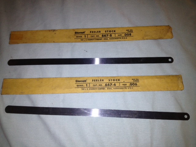

A tip given to me by the person that showed me how to adjust my valves; get long feeler gauges like the ones pictured. You won't have to remove the heater boxes etc. to reach the adjusters. And it saves your knuckles.

QUOTE(dcheek @ Mar 27 2014, 03:35 PM) *
(IMG:style_emoticons/default/agree.gif) 100% (IMG:style_emoticons/default/smilie_pokal.gif)
