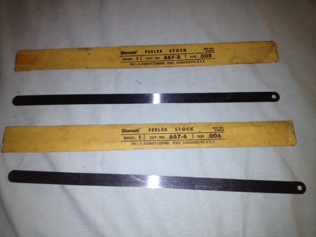

A tip given to me by the person that showed me how to adjust my valves; get long feeler gauges like the ones pictured. You won't have to remove the heater boxes etc. to reach the adjusters. And it saves your knuckles.
rmital
Mar 27 2014, 02:37 PM
QUOTE(dcheek @ Mar 27 2014, 03:35 PM)
100%

Actually the best feeler gauge is the "Go/No-Go" style.
It leaves nothing to "guess" if the feeler is tight enough or not.
I bought a brand new set at my FLAPS and then installed Jakes pushrods, so I dont need feeler gauges anymore....
