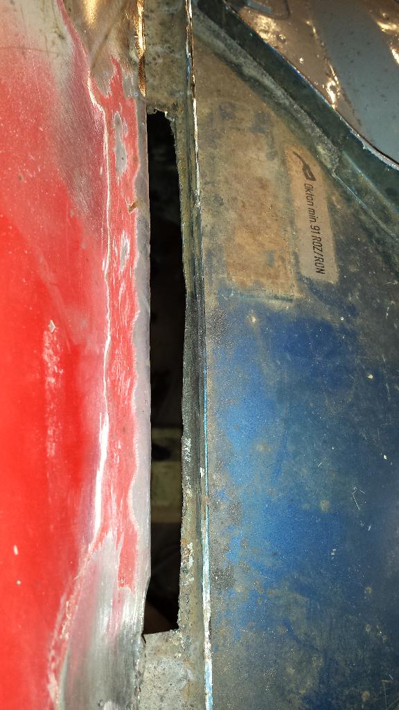

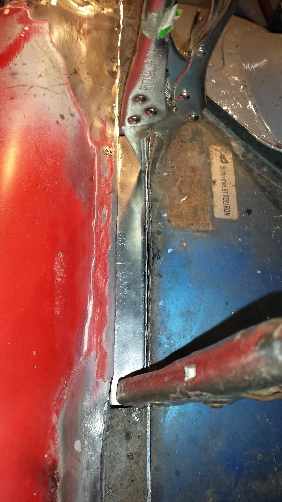

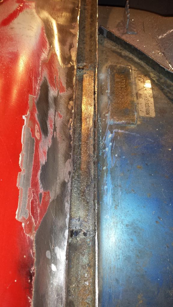

Beside the replacement fender there was a rust through in the hood molding channel. I cut that material out prior to attaching the fender. Last night I cleaned up the cut out, fabed up a patch and got that welded in. I think I'm about ready to start dressing up the fender, wheel well and front panel. Probably going to use POR 15 on all that.
