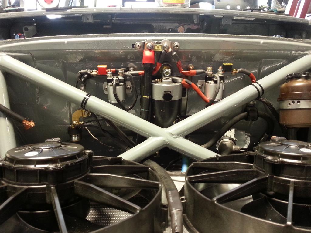

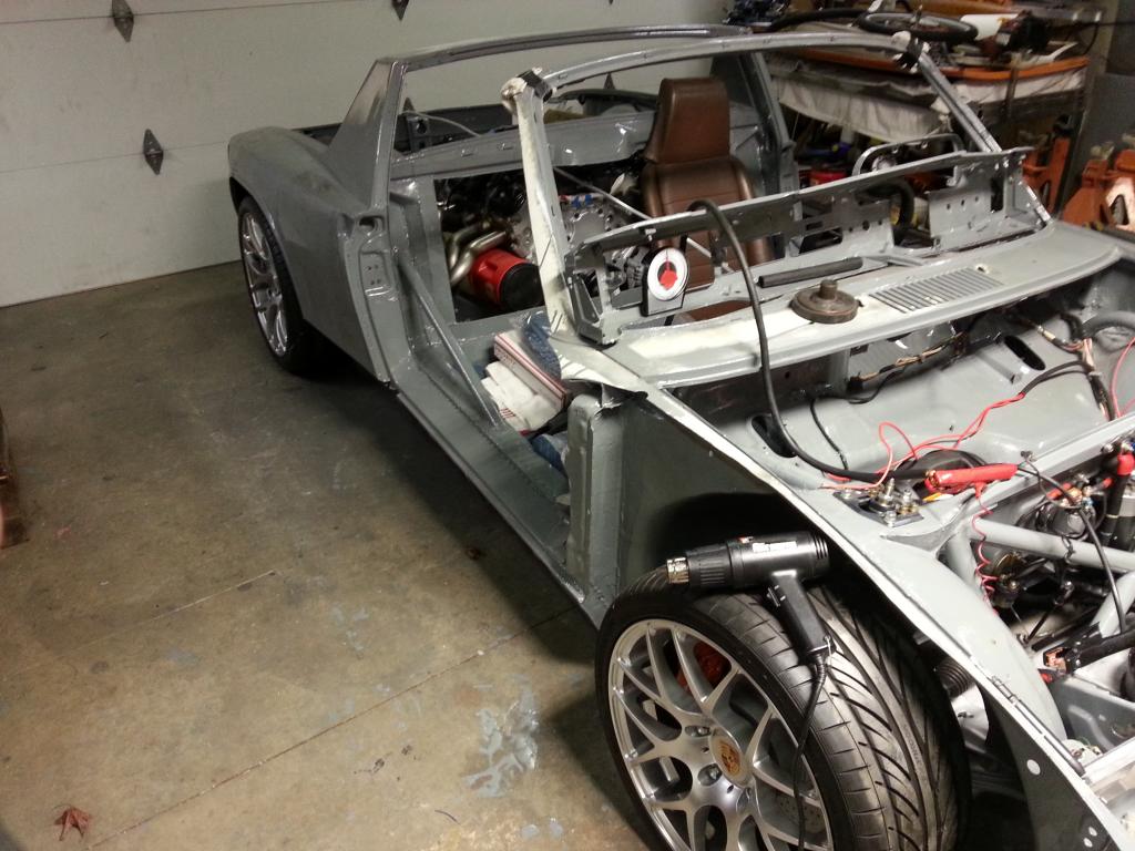

Installed some fuses to the fans & power steering systems. Good advise considering my last V8 914 had a electrical fire. (IMG:style_emoticons/default/poke.gif)
(IMG:http://www.914world.com/bbs2/uploads_offsite/i60.photobucket.com-3782-1396051875.1.jpg)
(IMG:http://www.914world.com/bbs2/uploads_offsite/i60.photobucket.com-3782-1396051876.2.jpg)
(IMG:http://www.914world.com/bbs2/uploads_offsite/i60.photobucket.com-3782-1396051876.3.jpg)
I found some nice hose 1.25" & 1.50" for only 6 dollars a foot. Its Called ValuFlex GS It says good to 212 degrees a bit low but I'm sure in reality likely fine for much more. My build is designed to keep coolant temps below 200 degrees at al times.

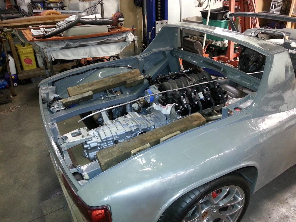

drive-ability   I got the car home was a long day. Here is a shot...   Sep 19 2013, 12:42 AM

drive-ability   Started wiring up the fans and P/S pump. Using 1 g...   Mar 20 2014, 09:49 PM
Jeff Hail   Started wiring up the fans and P/S pump. Using 1 ...   Mar 20 2014, 11:38 PM
drive-ability   http://www.914world.com/bbs2/uploads_offsite/i60.p...   Mar 24 2014, 01:09 AM
drive-ability   I found an extra Mercedes fan resistor set laying ...   Mar 25 2014, 11:45 PM
drive-ability   Question, My fans and electric power steering p...   Mar 25 2014, 11:54 PM
speed metal army   I would fuse them separately for sure. You want to...   Mar 26 2014, 12:02 AM
drive-ability   yes that's a good point ! I still have...   Mar 27 2014, 12:30 AM
drive-ability   Installed some fuses to the fans & power steer...   Mar 28 2014, 06:11 PM
