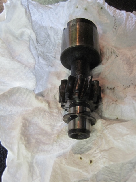

Hey guys!
Spring is here. So I started working on my poor motor today.
Someone gave me a suggestion that the squeak noise maybe caused by a dropped dizzy drive gear washer in the case.
So I took the gear out to see if the washer is still with it. Yep, the washer came out with no problem. It wasn't dropped in this case. Does the gear look OK for you guys?
Attached ImageAttached Image
I also tuned the flywheel a few cycles by hand again. It's not hard to turn with the all spark plugs removed. But there is a noticeable hardness at a point in the revolution. Somehow the squeak noise seems to have disappeared today.
Where should I go from here?
kkid (IMG:style_emoticons/default/smile.gif)

stugray   A squeal sounds like the fan is rubbing the housin...   Mar 28 2014, 09:50 PM
kkid   A squeal sounds like the fan is rubbing the housi...   Mar 28 2014, 10:00 PM
