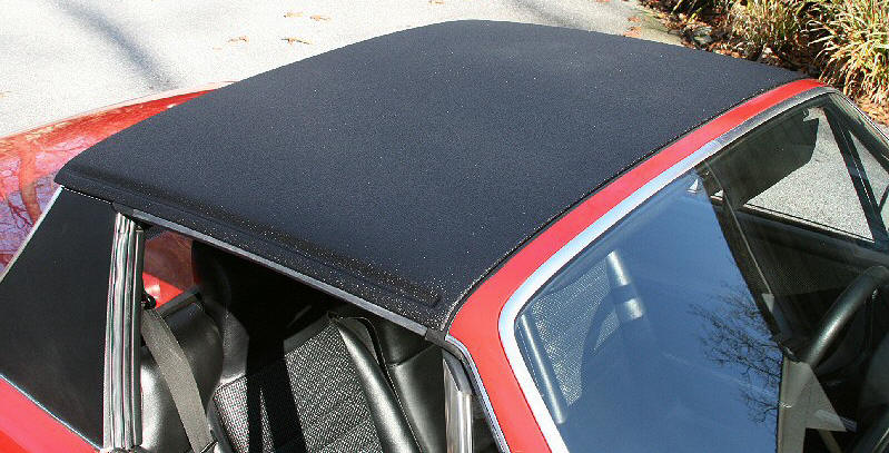

I took mine to a Line-X dealer. They sprayed mine for $175. Mine had a lot of chips and missing grain before taking it to Line-X. Looks like new except it is better! (IMG:style_emoticons/default/biggrin.gif)
Note: This is the same paint they use in truck beds so it it much more durable than regular paint. There are three dealers in Connecticut too! Picture does not it justice, sorry. (IMG:style_emoticons/default/biggrin.gif) Attached image(s)

PanelBilly Me too. I got the Kevlar LineX. Stuff is strong Mar 30 2014, 10:09 AM
cal914 I had mine LineX as well and it looks great would ... Mar 30 2014, 12:29 PM
CTDan914 You guys that had Line-x do it. Did the Lin-x add ... Mar 30 2014, 05:31 PM
PanelBilly Its thin and light. We're now talking about a ... Mar 30 2014, 05:56 PM![]() ![]() |
