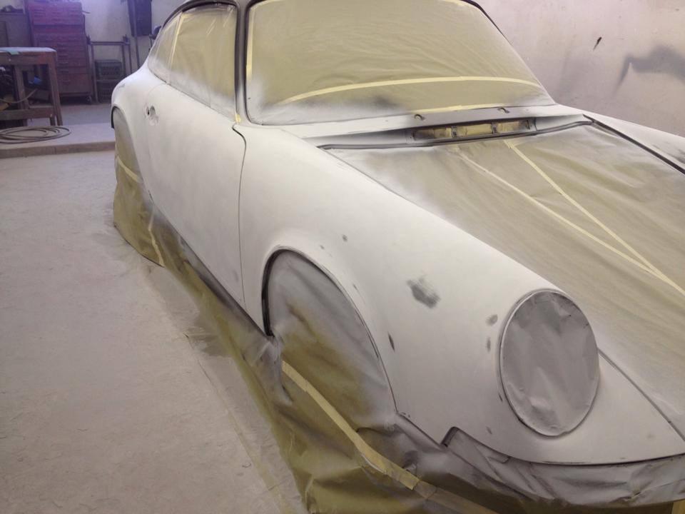

Mike came to us last year after finding us here for a PPI. In this case it was a "Post Purchase Inspection". The car was sold as a rust free (yes, enter your comments here) 3.2 six conversion. It turns out it was anything but. Regardless, Mike was in for the long haul and, he was determined to do things properly. He expressed interest in making the car a wide-body and fixing what needed to be fixed at the time.

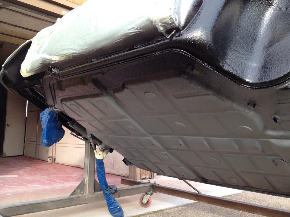

Off the tub went to be stripped and prepped for flares and paint work. Here you can see the "after" shot with the flares on and glass panels being fitted:
(IMG:http://www.914world.com/bbs2/uploads_offsite/scontent-b-lga.xx.fbcdn.net-1110-1386435699.1.jpg)
There was a lot of metal work needed as indeed... the rust was free on this one. Before flares could go on, a new quarter panel was needed and various stiffening kits (factory and 914LTD) added to ensure minimal twist with an impending 3.6 install. The car was then painted "Signal Orange" and given back to Mike for some detail installments.
