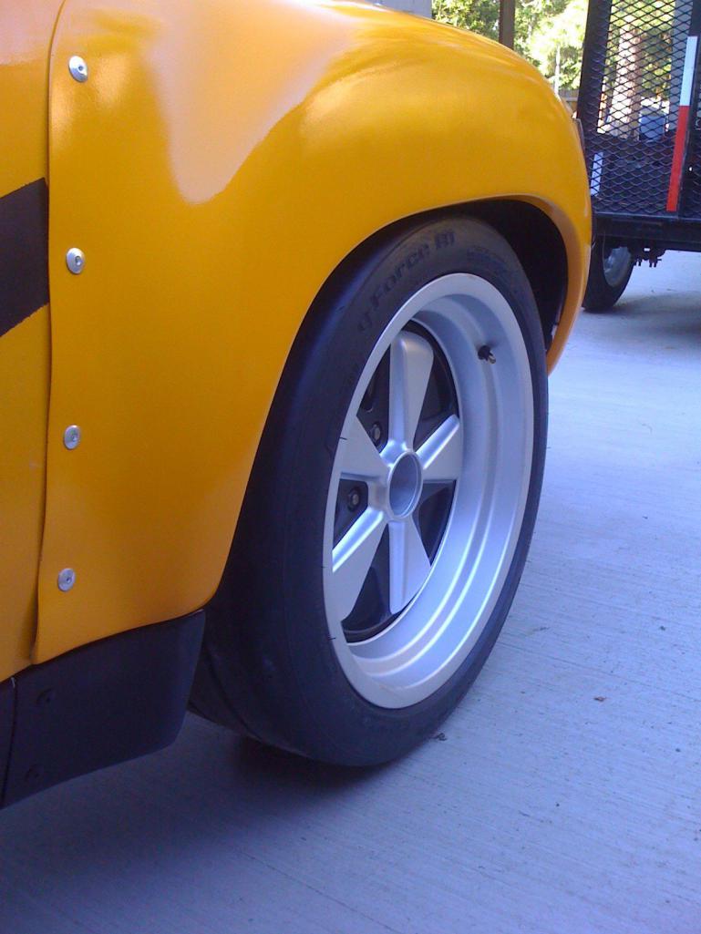

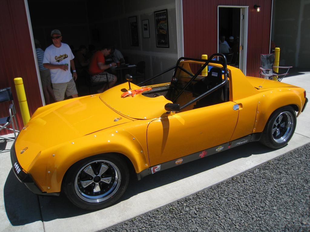

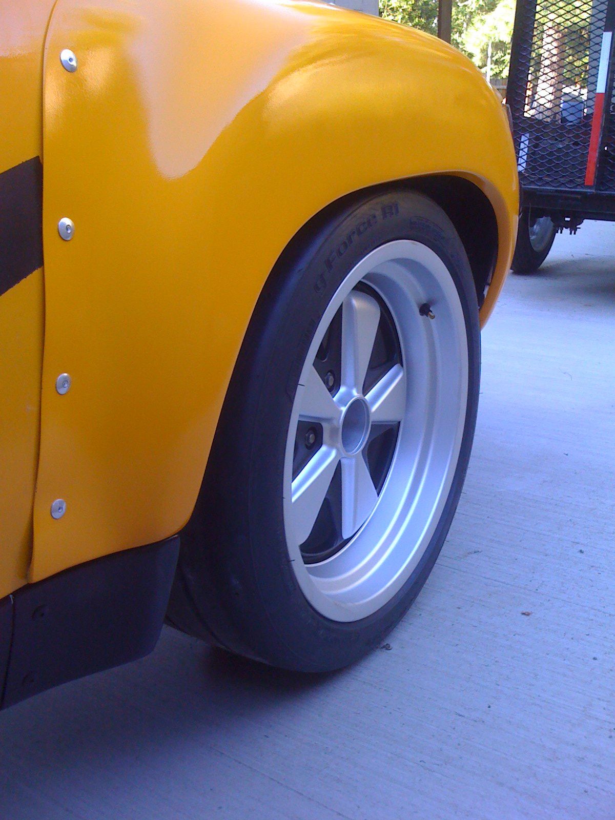

track day rivet flares - Rivets from Pegasus racing.
Not worried about the "blend" as it is a track only car, but there are new rockers in the near future...
