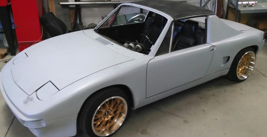

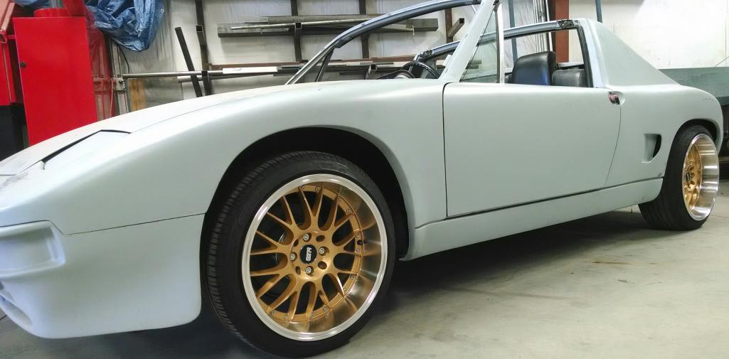

Hello 914 world and welcome to my thread ....I'm in the process of a conversion with a ez30r I have been collecting parts since december of 2012 its going to be a long road ahead but I see the promise land ahead
Here she is one long search 10 hour drive and a trade later she is mine (IMG:style_emoticons/default/biggrin.gif) bodywork was all done prior and anti rust agent was done by last owner

JRust   Get some longer studs. The offset on those won...   Jul 27 2013, 11:49 AM
Andyrew   More like 1.5 front and 2.5-3 back. :)   Jul 27 2013, 11:24 PM

3d914   Cool project! Looks like the kit was done well...   Jul 28 2013, 05:41 PM
bulitt   Yes spacers will be needed for those wheels.   Jul 28 2013, 05:46 PM
