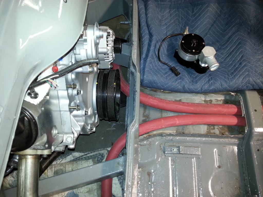

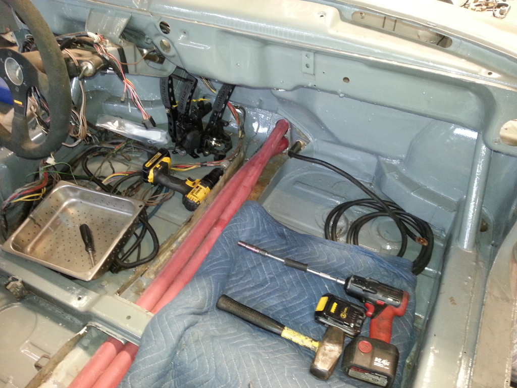

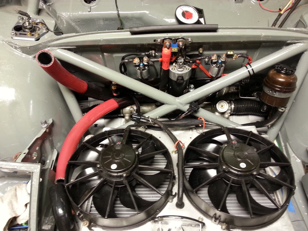

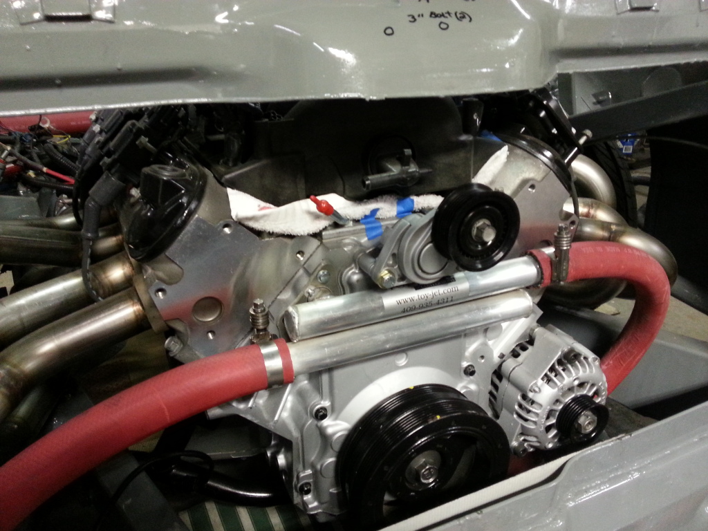

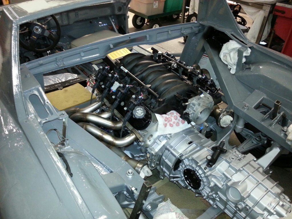

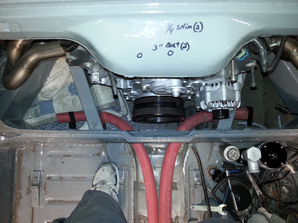

More Progress (IMG:style_emoticons/default/smile.gif)
I decided to run larger coolant hoses this time as I may build a much bigger engine. Now just a 400 hp unit. the lines are 1 1/2 & 1 1/4 and I had to open up the center tunnel as I'm running them in the car.
(IMG:http://www.914world.com/bbs2/uploads_offsite/i60.photobucket.com-3782-1397968657.1.jpg)
(IMG:http://www.914world.com/bbs2/uploads_offsite/i60.photobucket.com-3782-1397968657.2.jpg)
(IMG:http://www.914world.com/bbs2/uploads_offsite/i60.photobucket.com-3782-1397968657.3.jpg)
(IMG:http://www.914world.com/bbs2/uploads_offsite/i60.photobucket.com-3782-1397968658.4.jpg)
(IMG:http://www.914world.com/bbs2/uploads_offsite/i60.photobucket.com-3782-1397968658.5.jpg)

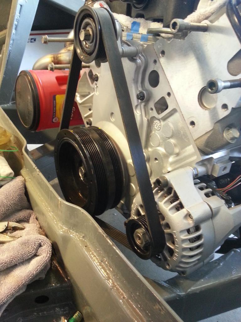

Here's a look at the drive belt, I didn't think the tensioner would fit with the Toy-Jet coolant manifold but got lucky (IMG:style_emoticons/default/biggrin.gif)
(IMG:http://www.914world.com/bbs2/uploads_offsite/i60.photobucket.com-3782-1397968658.7.jpg)
