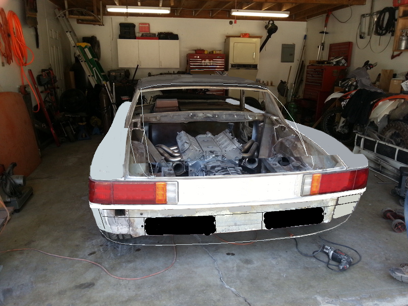

(IMG:http://www.914world.com/bbs2/uploads_offsite/i60.photobucket.com-3782-1396051875.1.jpg)

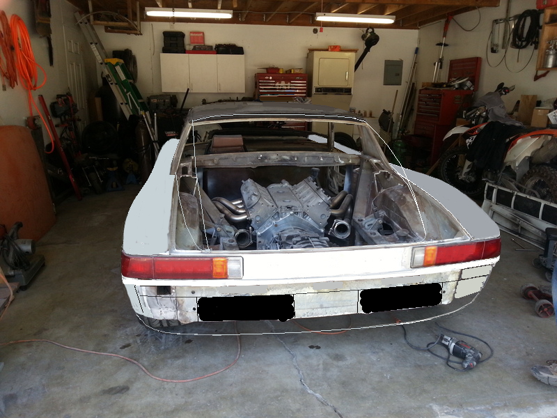

(IMG:http://www.914world.com/bbs2/uploads_offsite/i60.photobucket.com-3782-1396051876.2.jpg)
Since I sampled the pix some time ago,you have done an incredible amount of work.And just as I have envisioned it.those wide fenders look great.
An inspiration to us all,proof in metal.Integrating the latemodel part#'s is ingenious.You are way ahead of me.
I messed around with it a little recently in my own efforts to evolve the 914.
Some radical raising of the trunkline,to receive 944-like glass/plexi.
