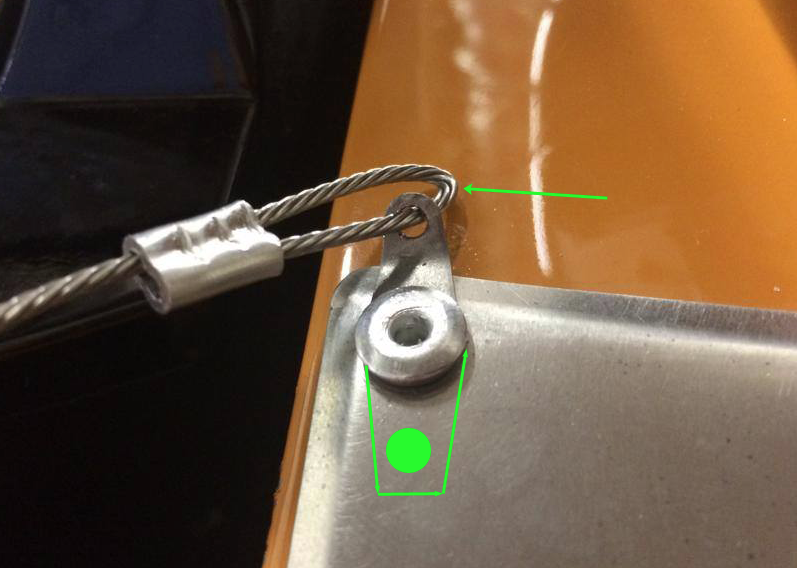

Wouldn't it make more sense to install the tab like this, so the cable doesn't scratch the paint?

CptTripps   Wouldn't it make more sense to install the tab...   Apr 30 2014, 10:10 AM
bulitt   Sorta thought the same thing.   Apr 30 2014, 10:14 AM
