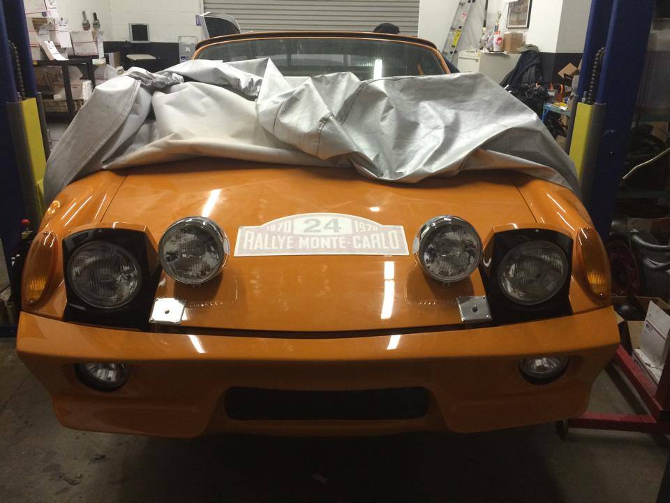

It looks like we'll still need to adjust the lights a bit but, they are on and wired. The lights themselves are extremely impressive. The wiring inside them was not. Very short with with inexpensive bullet plugs that would pop out at will. We went through and fixed all of that...
(IMG:http://www.914world.com/bbs2/uploads_offsite/scontent-a-sjc.xx.fbcdn.net-1110-1398862622.1.jpg)

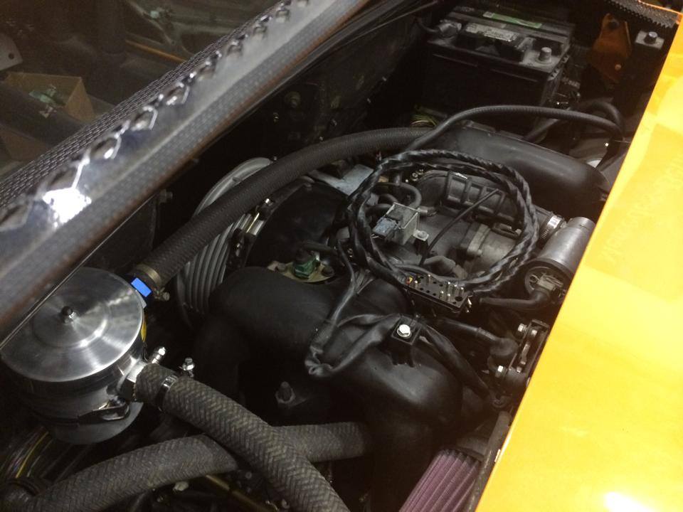

The engine and tranny are in (as mentioned) and only a bit of harness work to be performed. This is a test fit which allowed us to cinch up the oil hard and soft lines and resolve the intake and other various fitment issues. You can see the purchased 14-pin engine harness connector laying on the top. Only 5 of the pins in this "purchased" harness were correct. Reverse lights were missing and the low oil indicator was going to the hand lever for the heater blower switch! (IMG:style_emoticons/default/wacko.gif) We had to go in and add the reverse wires and change (quite) a few things around. In the end... just purchase a few 14-pin ends and do it yourself.
(IMG:http://www.914world.com/bbs2/uploads_offsite/fbcdn-sphotos-h-a.akamaihd.net-1110-1398862624.2.jpg)

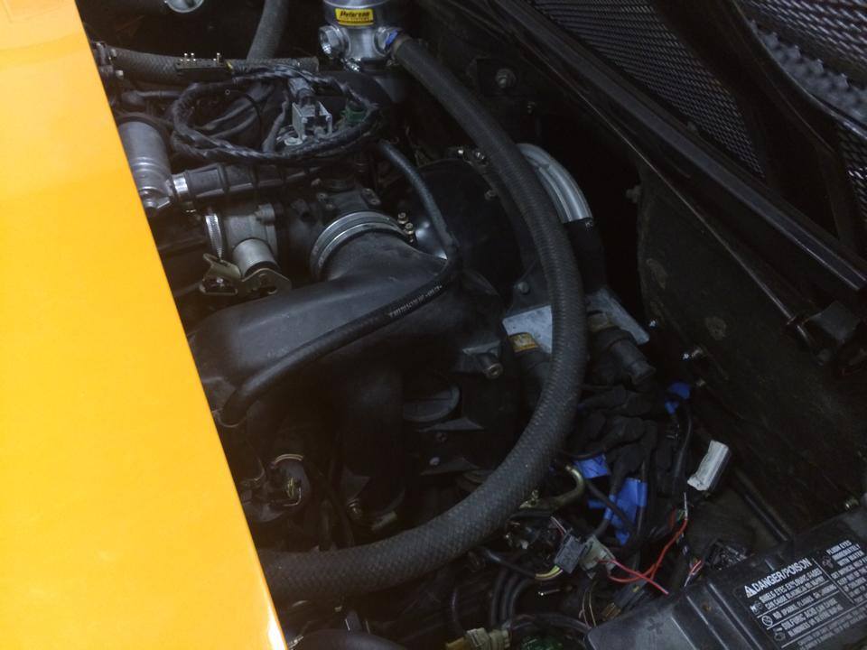

All of the fuel lines and hoses have been run. Just a little tidying up to do there and it should be good to go.
(IMG:http://www.914world.com/bbs2/uploads_offsite/scontent-b-sjc.xx.fbcdn.net-1110-1398862624.3.jpg)

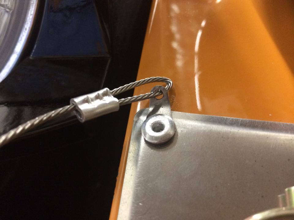

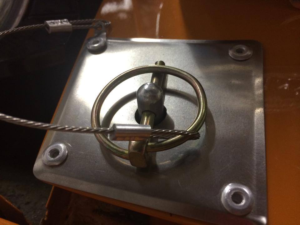

We installed a nice system for the hood pins (and yes, buttheads... we installed a set on my car as well) (IMG:style_emoticons/default/dry.gif)
(IMG:http://www.914world.com/bbs2/uploads_offsite/fbcdn-sphotos-c-a.akamaihd.net-1110-1398862624.4.jpg)
(IMG:http://www.914world.com/bbs2/uploads_offsite/fbcdn-sphotos-b-a.akamaihd.net-1110-1398862625.5.jpg)

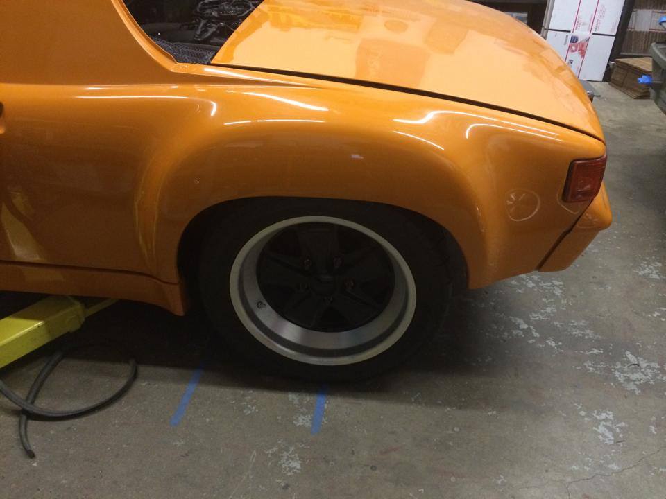

We also set a preliminary ride height with the motor and trans in. Hard to believe but, it looks as though the massive rubber will fit!
(IMG:http://www.914world.com/bbs2/uploads_offsite/scontent-b-sjc.xx.fbcdn.net-1110-1398862625.6.jpg)
