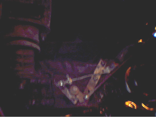

All the teeners on this BBS crack me up. (IMG:style_emoticons/default/laugh.gif) It is so cool how one small statement can lead into a large disscussion thread about TToD's in 914's. That rocks!
So anyway, I will have to take better pictures of this with my regular camera. Seems my $25 digital one is not up to the task. (IMG:style_emoticons/default/unsure.gif)
So here is one of the shots (terrible I know) of my home made bell crank throttle linkage. I will post better pictures later on. Lets look a little at what a did and why I did it that way:
I started out finding I one ball and two cups. What I mean by that is one little throttle linkage ball and two of the snap on cups that thread onto throttle linkage rod. I also went down to the hardware store and purchased 3/16 rod for $1.99 which I used about half of it for this job. Oooooh, big money huh? What do Bell Cranks cost? $300? It took me an hour to make this one. I promise better pitcures will come. In this picture if you can see it (no flash, DERRRR!) (IMG:style_emoticons/default/wacko.gif) Is the completed set up. I used the factory 914-4 cable....oh, get how I hooked it up, I used the cable clamp system off of one of the heater valves, so there is one other part needed. Notice the cable comes from above the CV and is even above the rod..... If you can see it, again sorry about that. I do this to ease the pull and help keep it simple and progressive. When I made the pivot for this, I made sure my pull was equal for both cable and rod.
