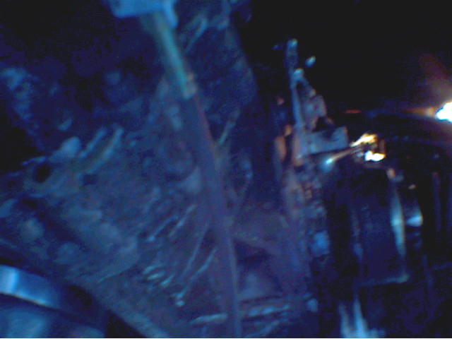

So I welded 2 small pieces of steel brackets together. One 90 to hold the cable welded onto a flat bar with holes drilled into it to mount the pivot to. I think you can see how I mounted all this on the trans. Simple, just a few brackets laying around the garage did the trick. Each one of these I have done has been a little different since I have never used the same parts to make it. Just what is lying around. WHich means this is a simple item to make. Don't think about it that much, you are just changing the direction of a pull, simple. Here is another sucky shot of the rod I made that goes up to the carb's. That's it, the rest up there in the engine bay is all stock. You can sort of make out the rod below the cable, but both still above the CV.
No it doesn't rub on anything and yes, the throttle form inside the car is smooth. I will probably take my unit back off the car and take pictures of it. My wife and I drove the 914 around last night for the first time as a 914-6, so I was sort of excited to get things just on and done. But for the sake of readers on this thread, I will remove it and get more details on it. Attached image(s)
