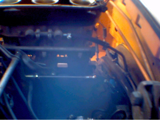

So here is yet another sucky shot of the rod I made coming up to the carbs. What I did with the rod was thread one end about 1.5" down the rod using a 5x1.0 tap(or is it die?) (IMG:style_emoticons/default/wink.gif) Screwed on a little nut and the cup, snapped it on the carb end, held up the pivoted linkage I made until it was about where I wanted it, marked the rod. I cut the rod, threaded the other end and presto, done. About the only factors in the length of the rod were how long the cable was so I wouldn't have to modify that. You want to use a factory 914-4 cable. They are cheap and you can get them almost anywhere. Plus I have tons and tons of adjustment room.
