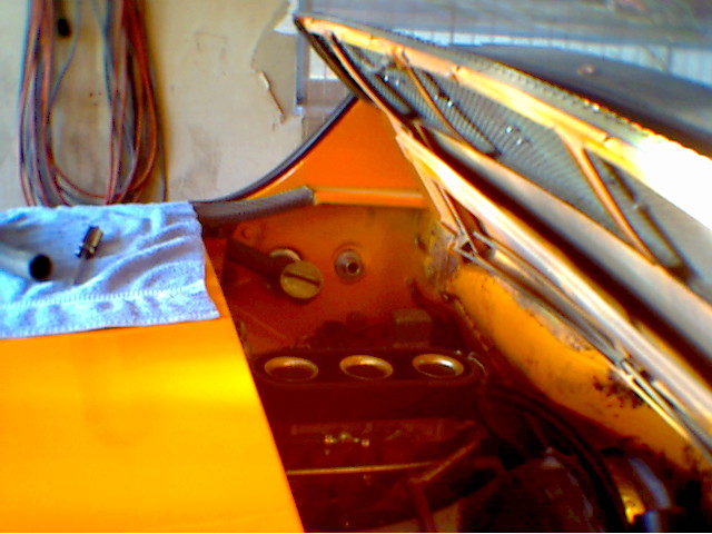

Here is a shot of the holes drilled for the oil tank. Yep, I am using a Vellios tank yet again. They work great and use the later filters. Also, you can go down to your local industrial supply shop and have them make the pressure hose for like $40. The suction hose is even easier, but more on that later.
