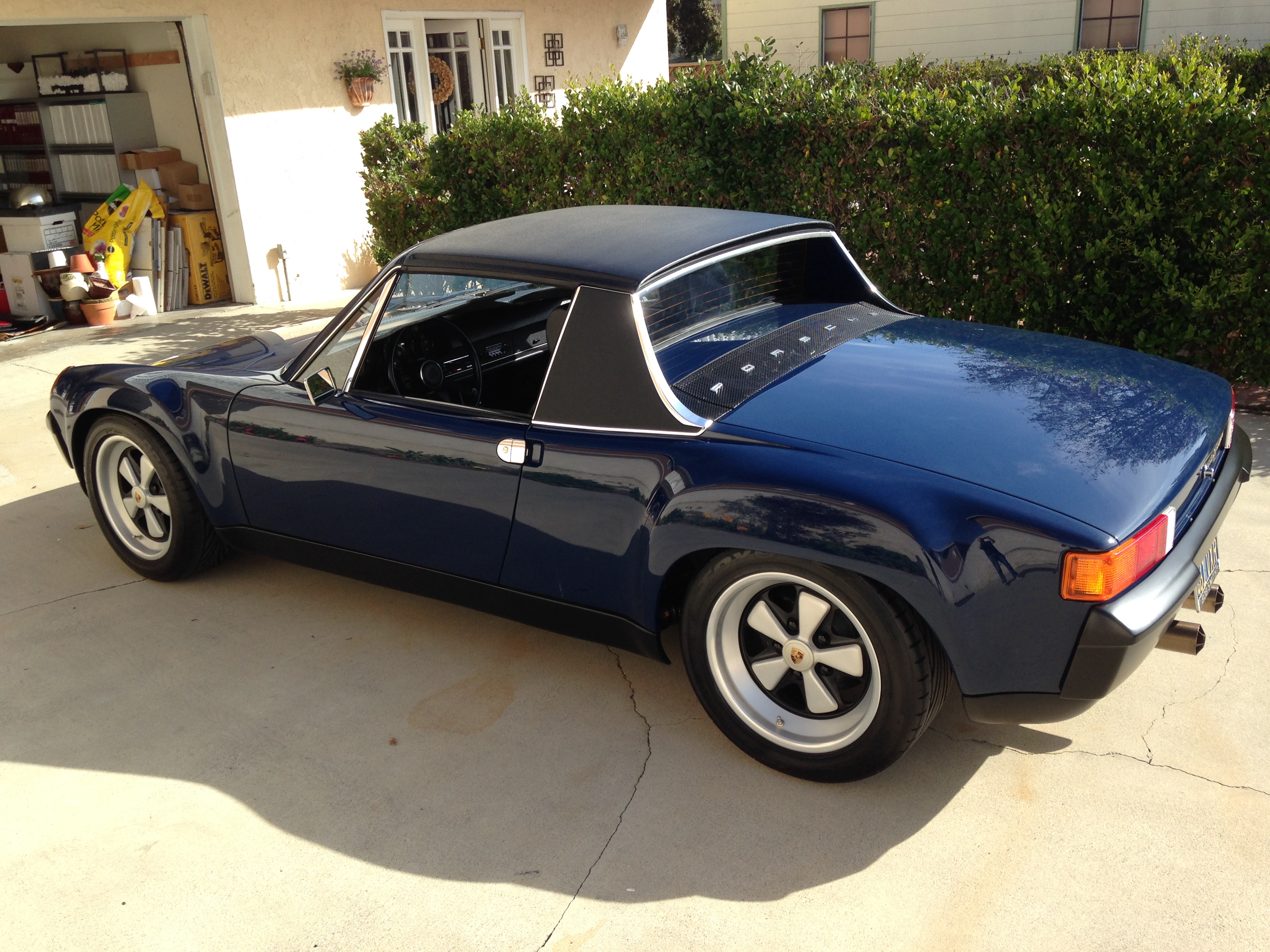

Eric_Shea   So much has been done but so little to show! I...   Apr 30 2014, 06:57 AM

puffinator   Hey Gang, We've been working on this one for...   May 1 2014, 06:49 AM
914mikee100   The 916/rally split personality is due to the leng...   May 1 2014, 04:13 PM
