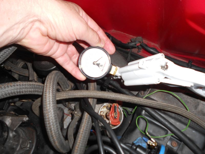

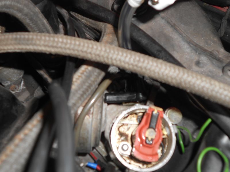

Well finally had a chance to check the vacuum advance on the distributor.
Here are the steps I took (photos to follow).
1. Removed distributor cap
2. Disconnected the vacuum hose

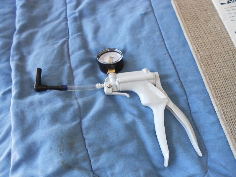

3. Hookup up a vacuum gauge (hand pump to bleed brakes) to vacuum advance on distributor
4. Pump up the vacuum and checked movement of arm.
5. No movement on arm
6. Hookup vacuum gauge on other line
7. Pump up vacuum and noticed movement on arm

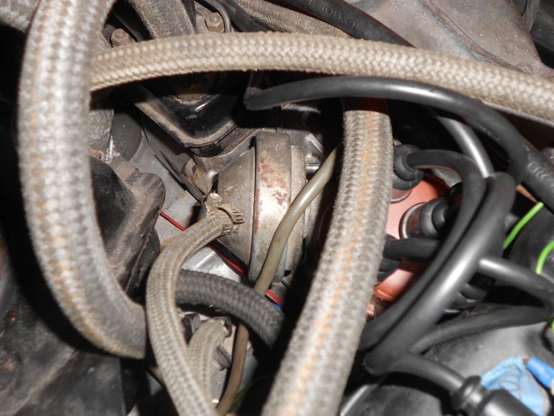

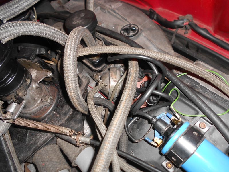

8. Reconnected vacuum line to other side of vacuum advance (using a hose clamp)
9. Test drove car
Conclusion: the car didn't sputter, but now the idle is around 1600 RPM, before was 900 RPM.
So is this a good solution?
If this is a good solution I'll readjust the idle.
