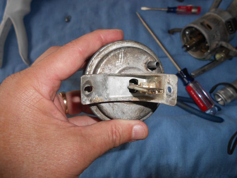

Thanks for everyone's suggestions. I have pulled the distributor and removed the vacuum advance. I visually checked the arm and it looks clean. I also manually was able to move it. I hooked up a vacuum gauge to the advance port and nothing moved nor did it hold vacuum. I hooked up to the retard port and was able to get vacuum and movement.
At this point I'm assuming the advance side isn't working and I've placed an ad for a2.0l vacuum advance.
Once I've replaced the vacuum advance I'll reinstall the distributor, hook up the vacuum hose and test the car again.

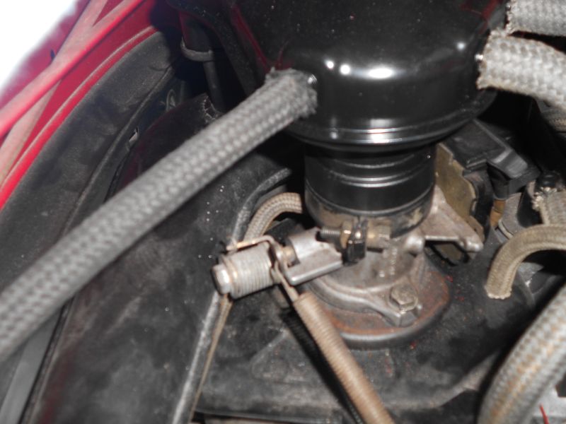

Also someone commented about the vacuum hose not routed correctly, I've included a photo of where the hose is connected to the plenum.
Stay tuned for more updates.
Vacuum advance, advance side where arm comes out.

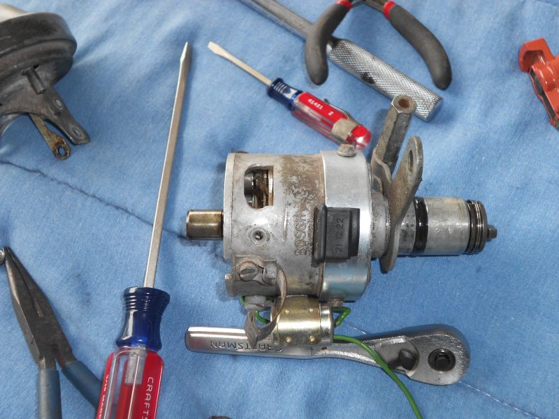

Distributor (039 905 205A) with vacuum advance removed. The advance is removed by removing the circlip from the distributor and (2) screws.

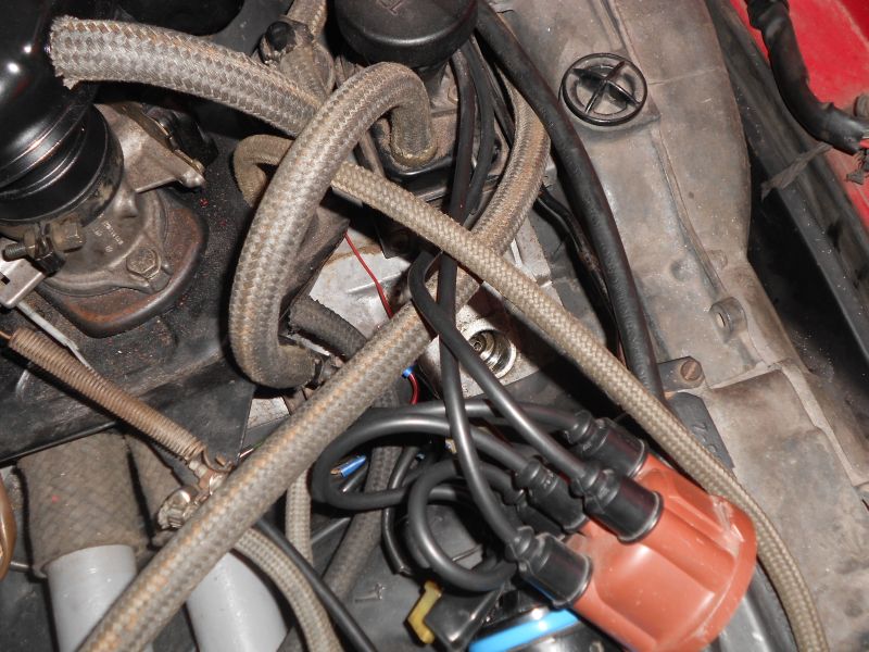

Distributor removed. The distributor is easily removed by removing the wires to the FI trigger and coil and unbolting the mounting nut and washer. Do NOT loosen the locking arm.
Location of the vacuum advance hose on the plenum.

The Cabinetmaker   One port is advance, the other is retard.   May 10 2014, 12:19 PM
boxsterfan   I think your vacuum line (as pictured) is hooked u...   May 10 2014, 02:08 PM
r_towle   Yup, one is advance, one is retard. Retard was lef...   May 10 2014, 02:12 PM
watsonrx13   Rich thanks for the reply, that explains everythin...   May 10 2014, 03:46 PM
The Cabinetmaker   Where does the hose with the clamp go to? It's...   May 10 2014, 04:06 PM
914_teener   I really think you should yank that dizzy out and ...   May 10 2014, 11:06 PM
watsonrx13   Thanks for everyone's suggestions. I have pull...   May 11 2014, 08:08 AM
r_towle   Remove the other two screws and pull out the actua...   May 11 2014, 08:51 AM

watsonrx13   OK, I reread your reply and did the following 1. ...   May 11 2014, 09:44 AM
Dtjaden   Carb or brake cleaner would work well. The RS clea...   May 11 2014, 10:08 AM
watsonrx13   Cleaned parts. BTW, I added a small amount of grea...   May 11 2014, 10:23 AM
watsonrx13   Successful test drive. The engine idles great and ...   May 11 2014, 10:52 AM
r_towle   Was at moms today. You found it.... I use whateve...   May 11 2014, 04:01 PM
