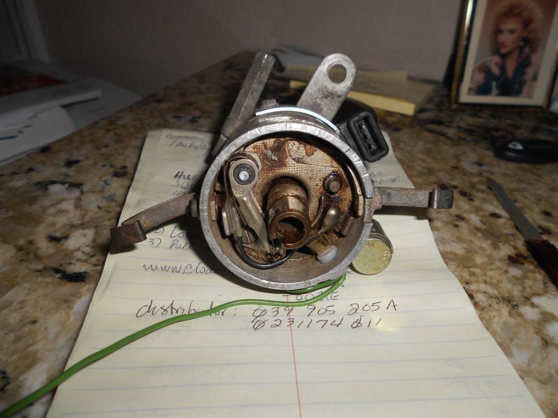

watsonrx13   Well finally had a chance to check the vacuum adva...   May 10 2014, 10:39 AM
r_towle   The distributor has never been cleaned...well it...   May 10 2014, 10:45 AM
watsonrx13   The distributor has never been cleaned...well it...   May 10 2014, 12:14 PM
type47   I checked the vacuum advance on a distributor on a...   May 10 2014, 10:51 AM
r_towle   I checked the vacuum advance on a distributor on ...   May 10 2014, 10:52 AM
type47   I checked the vacuum advance on a distributor on...   May 10 2014, 04:06 PM
The Cabinetmaker   One port is advance, the other is retard.   May 10 2014, 12:19 PM
boxsterfan   I think your vacuum line (as pictured) is hooked u...   May 10 2014, 02:08 PM
r_towle   Yup, one is advance, one is retard. Retard was lef...   May 10 2014, 02:12 PM
watsonrx13   Rich thanks for the reply, that explains everythin...   May 10 2014, 03:46 PM
The Cabinetmaker   Where does the hose with the clamp go to? It's...   May 10 2014, 04:06 PM
914_teener   I really think you should yank that dizzy out and ...   May 10 2014, 11:06 PM
watsonrx13   Thanks for everyone's suggestions. I have pull...   May 11 2014, 08:08 AM
r_towle   Remove the other two screws and pull out the actua...   May 11 2014, 08:51 AM
watsonrx13   Rich, which (2) screws are you talking about remov...   May 11 2014, 09:19 AM
watsonrx13   OK, I reread your reply and did the following 1. ...   May 11 2014, 09:44 AM
Dtjaden   Carb or brake cleaner would work well. The RS clea...   May 11 2014, 10:08 AM
watsonrx13   Cleaned parts. BTW, I added a small amount of grea...   May 11 2014, 10:23 AM
watsonrx13   Successful test drive. The engine idles great and ...   May 11 2014, 10:52 AM
r_towle   Was at moms today. You found it.... I use whateve...   May 11 2014, 04:01 PM
