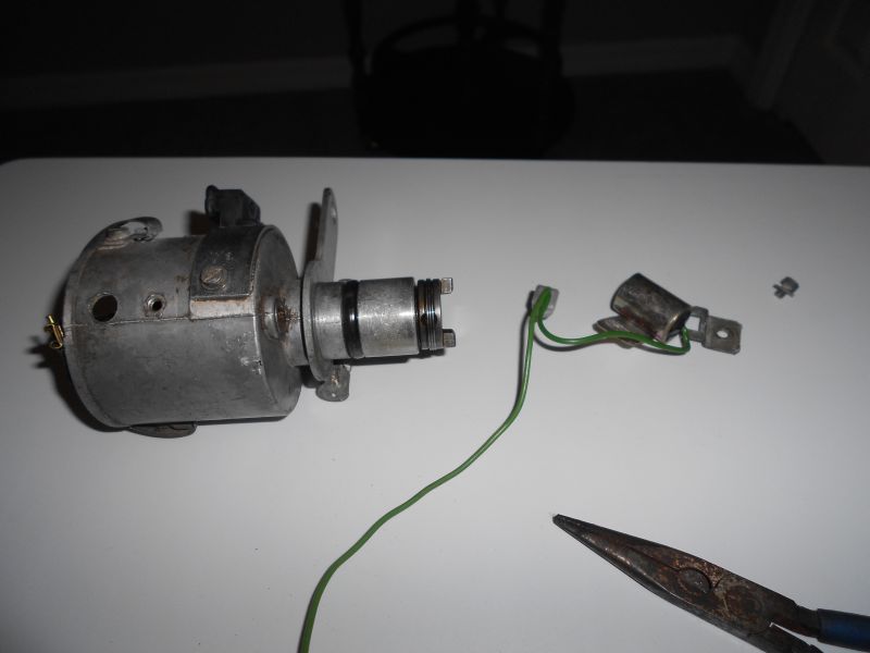

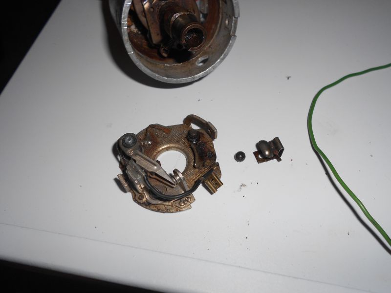

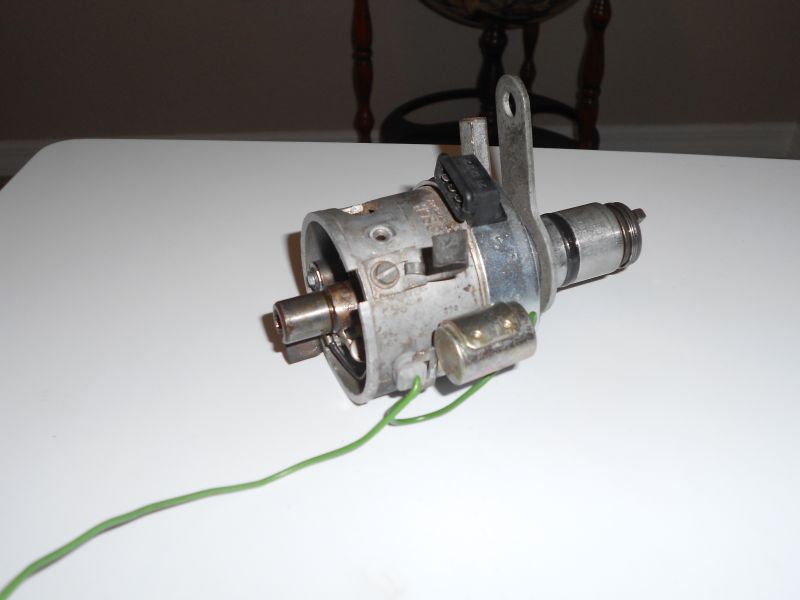

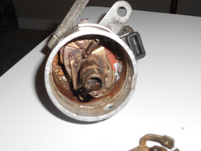

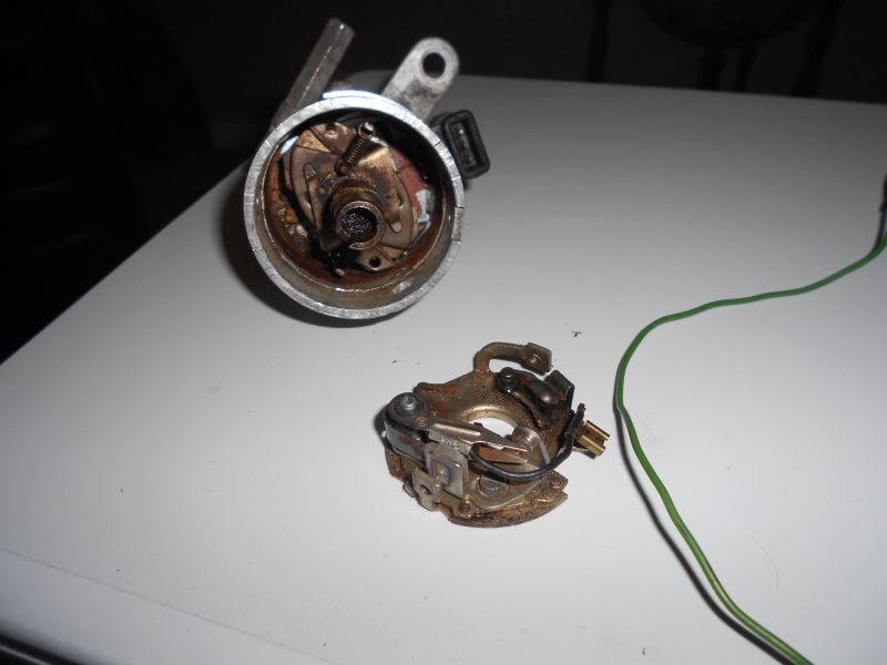

OK, I reread your reply and did the following
1. Removed screw from condenser and removed from distributor
2. Removed (2) screws that held the clips
3. Carefully removed the actual advance plates
4. Removed clip with ball bearing
What should I use to clean the parts? Can I use some aerosol electronic cleaner I got from Radio Shack?
After cleaning, where should I put grease?
Before shot
After condenser removal
After (2) clip and advance plate removal
Dirty distributor
Clip with ball bearing removed

Carb or brake cleaner would work well. The RS cleaner will most likely not be strong enough.
