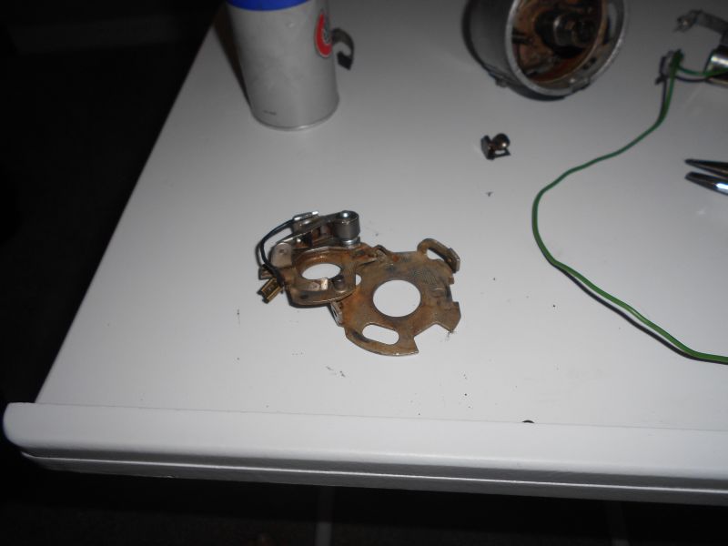

watsonrx13   Thanks for everyone's suggestions. I have pull...   May 11 2014, 08:08 AM
r_towle   Remove the other two screws and pull out the actua...   May 11 2014, 08:51 AM
watsonrx13   Rich, which (2) screws are you talking about remov...   May 11 2014, 09:19 AM
watsonrx13   OK, I reread your reply and did the following 1. ...   May 11 2014, 09:44 AM
Dtjaden   Carb or brake cleaner would work well. The RS clea...   May 11 2014, 10:08 AM
watsonrx13   Cleaned parts. BTW, I added a small amount of grea...   May 11 2014, 10:23 AM
watsonrx13   Successful test drive. The engine idles great and ...   May 11 2014, 10:52 AM
