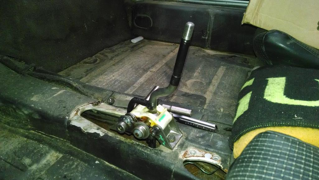

Porscharu73   Bought a 91 celica shifter from a pick and pull ju...   May 13 2014, 11:37 PM
Porscharu73   feels like a short shifter   May 13 2014, 11:41 PM
Porscharu73   shifter fabricated and cables bought from a sho...   May 13 2014, 11:49 PM
