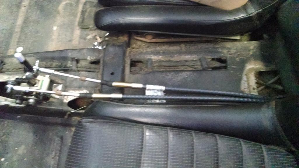

shifter fabricated and cables bought from a shop in town I have all my paper work for every part and will have a list at the end no shift mechanism at the moment
