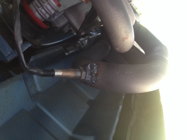

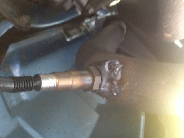

Ok here are the pics of my sensor location on a Bursch type exhaust.
This is from the passangers side. Sorry about the poor photo quality.
