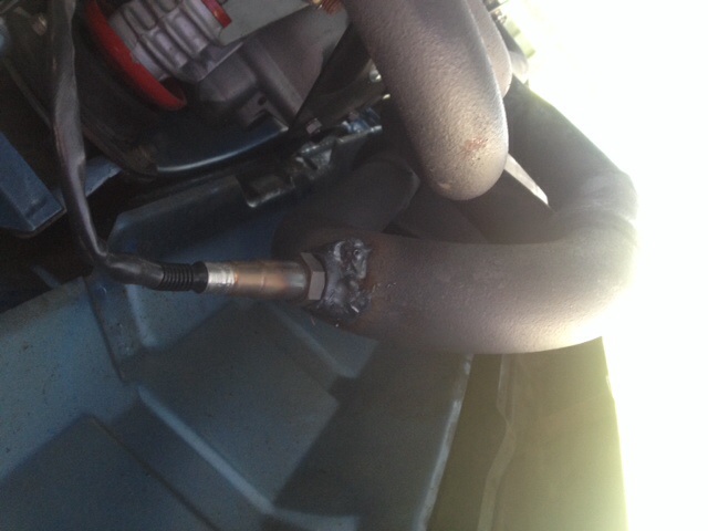

Ok here are the pics of my sensor location on a Bursch type exhaust.
Click to view attachmentClick to view attachmentThis is from the passangers side. Sorry about the poor photo quality.

The kit is less than detailed. But it does say where to mount generally but it does not say drill a 21 mm hole.
