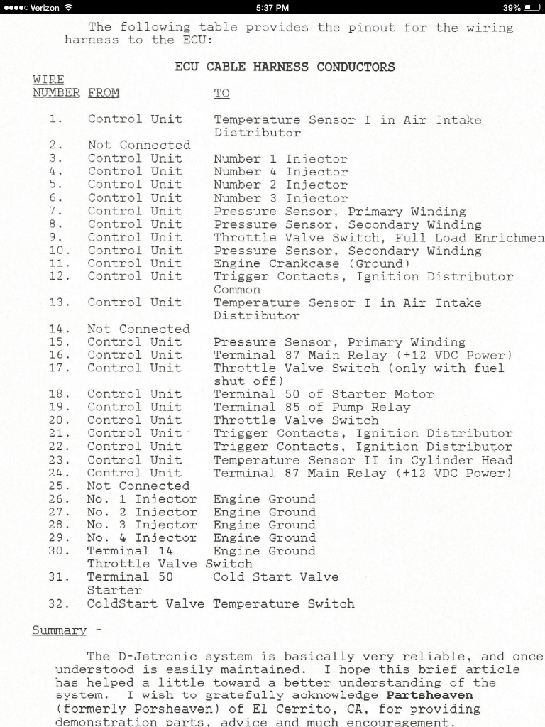

See the Cap'n expiation in post 18 here.
The kit is less than detailed. But it does say where to mount generally but it does not say drill a 21 mm hole.
I had something similar and found I had a poor connection on one of the injectors. Get your multi meter out and trace down all of the injector leads from the brain (ECU) to the injector connection. Move the injector wires around while checking continuity and see if you have a break.
Sorry the picture I posted was useless to you with the L-jet as the all fire at the same time.
