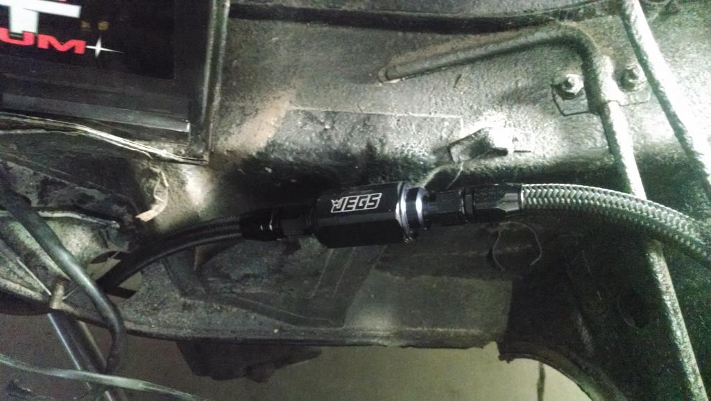

Porscharu73   I had some time to officially found the computerS...   May 18 2014, 05:48 PM
Porscharu73   Jegs fuel filter   May 18 2014, 05:50 PM
