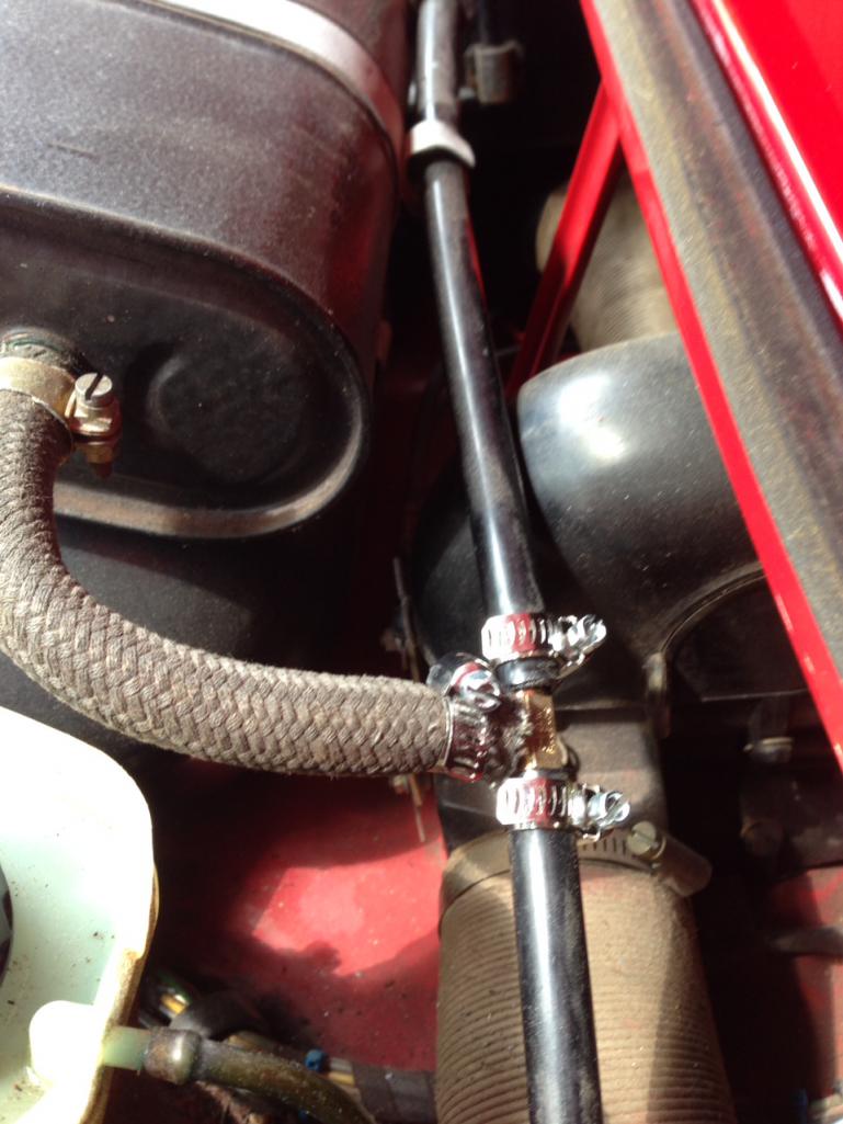

The only thing I see is this line is hanging out in space...could the smell be coming from here?
Should I cap it or does it need to connect somewhere?
Remember...this car has triple webers...it's not fuel injected.

Put a "T" in the drain hose and connected the open hose to it.
Drove the car for 30 miles and no gas smell!
Thank you for all the advice.
