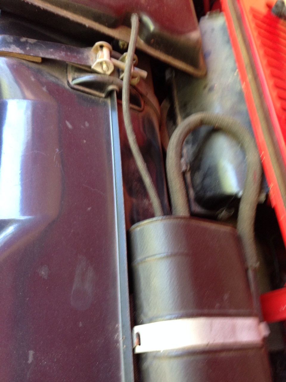

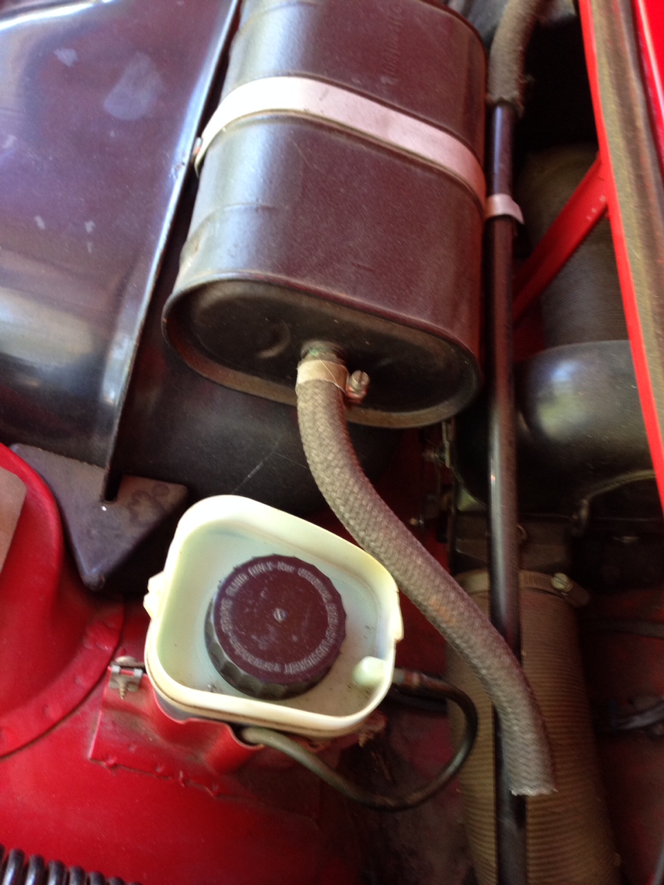

The only thing I see is this line is hanging out in space...could the smell be coming from here?
Should I cap it or does it need to connect somewhere?
Remember...this car has triple webers...it's not fuel injected.

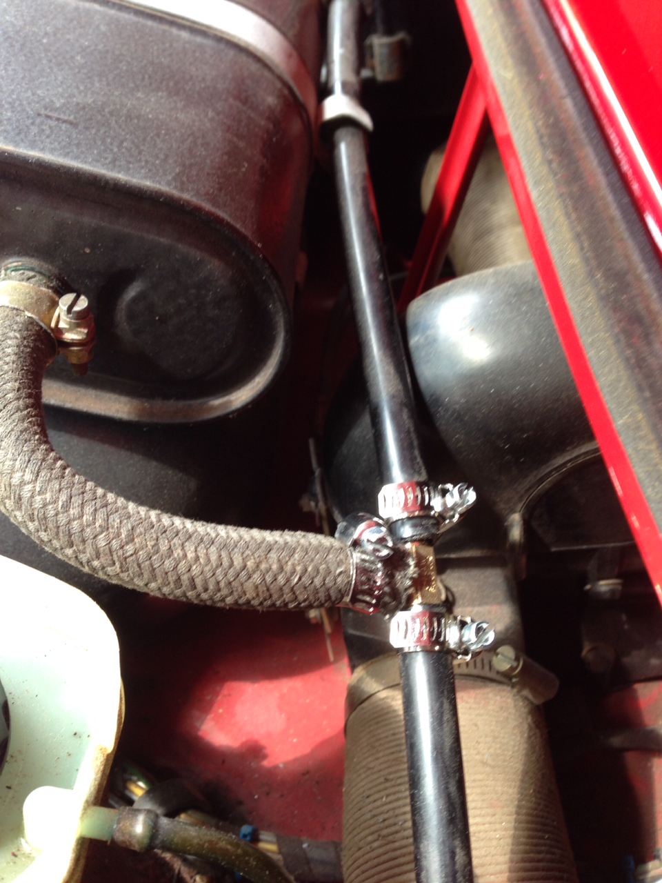

The "line hanging in space" would have gas fumes coming from it, probably should route it down like the overflow hose, don't cap it.

It's not like I really read all the somewhat clueless replies, but I can't believe no one told you to FIX the open vent line. It is OBVIOUS that some posters didn't even completely read the original post! It's got a freakin' PICTURE, for Pete's sake! That stray line runs from the evap can to the engine. There are two, one to a nipple on the fan shroud, and one to the air cleaner. They MUST be connected, and connected correctly. That's your gas smell! This, BTW, has been discussed numerous times right here in the Garage forum, and the answer to the problem has nearly always been the same. It's a PASSIVE emissions system, and it makes absolutely NO sense to disable or eliminate the plumbing!
The Cap'n
May 4 2014, 08:02 AM
so im guessing with the car running, more air is pushed into the system (engine fan) and more fuel vapor escapes. Hook up the line and the fuel vapor goes to the right place. Looks like a very simple fix.

Do not cap the lines from the tank. If you seal it tight enough, your fuel pump will keep sucking fuel, but no air will enter the tank to fill the void. After awhile you start generating vacuum in the tank and the car will stall out as the vacuum increases and the pump can no longer suck hard enough.
You can run a longer line down under the car, but you may still get a fuel smell.

Bill, unless they removed them you should have two plastic lines running from the front trunk near the brake fluid reservoir going down thru the fender well under the driver rocker panel into the rear fender well then into the engine compartment below the oil tank. On your charcoal filter the line coming out on the side with the small tube should be hooked up to one of the plastic lines then hooked to the air outlet port on your fan housing. The other end "hanging in space" should be connected to the other plastic line the connected to the air filter housing. This would put the system back functioning.
If you don't have the plastic lines you can route the hanging line down and under the car like the overflow tube like I stated earlier but don't cap it.
Also if that charcoal filter line is disconnected, where does the one on the other side go, they both would have fumes coming out.

billh1963
May 18 2014, 05:54 PM
Put a "T" in the drain hose and connected the open hose to it.
Drove the car for 30 miles and no gas smell!
Thank you for all the advice.
