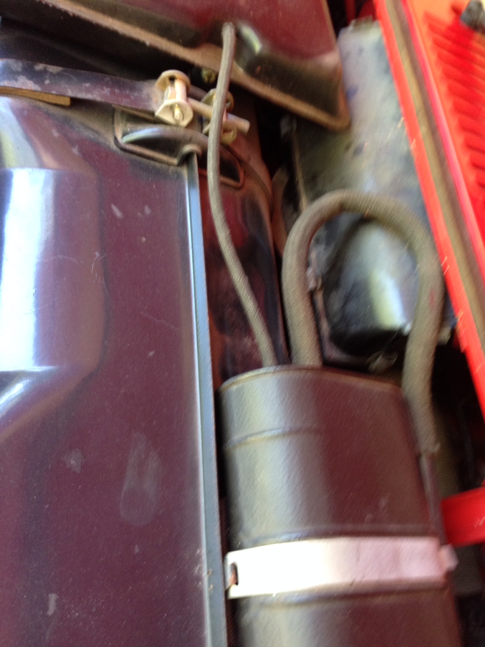

Update: 5/3
Drove the car extensively today and, as usual, the gas smell comes and goes. Stopped while the smell was strong and checked around the carbs...dry
Looked under the car...dry
Opened the trunk...no smell.
Even pulled the gear shift to see if there was a gas smell in the tunnel...nothing
The only thing I see is this line is hanging out in space...could the smell be coming from here?
Should I cap it or does it need to connect somewhere?
Remember...this car has triple webers...it's not fuel injected.

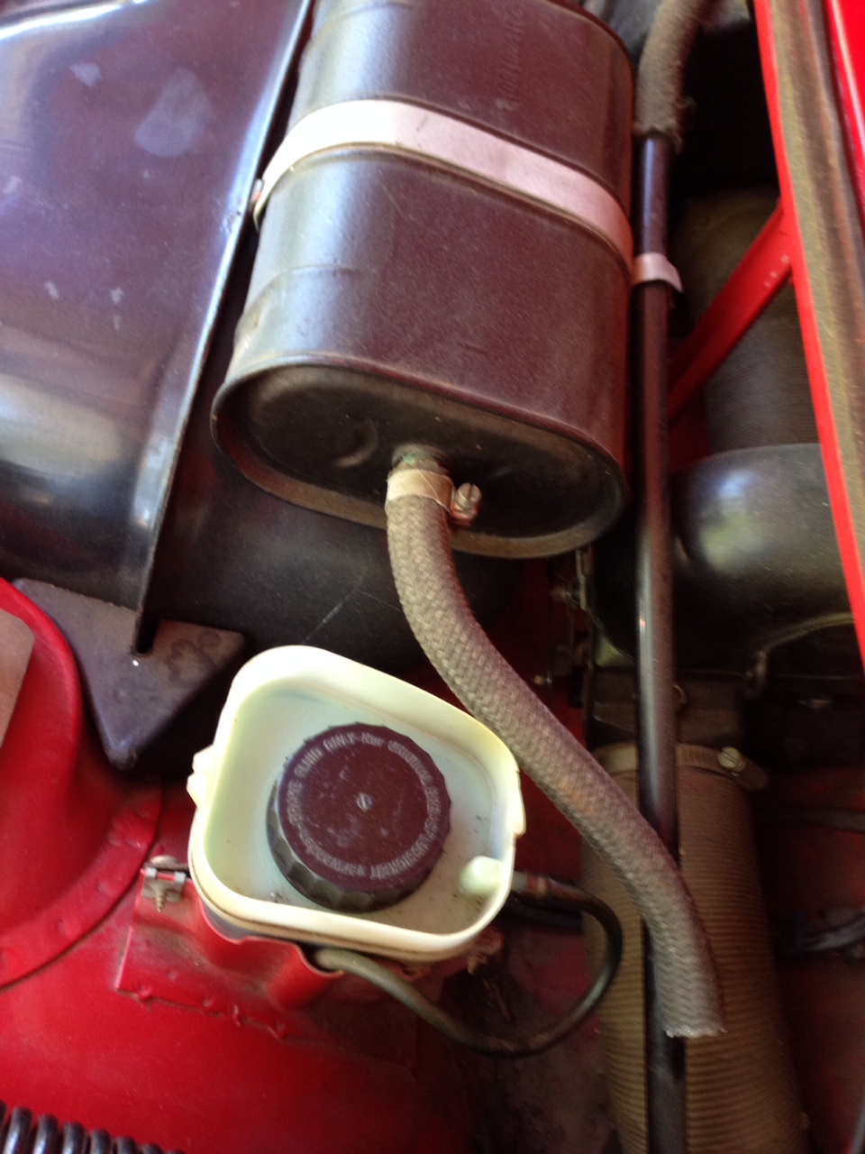

Do you still have the charcoal canister and expansion tank on top of the fuel tank?
Is the vent tube connected from the fuel tank to the charcoal canister. If you don't
have all of this stuff working you may be getting fumes venting from the gas tank.
Easy fix if the canister/expansion tank have been removed or are not functional. Make a small hole in the large overflow tube coming out of the tank filler neck.
Feed the small vent tube down into the hole in the overflow tube about 6". Make the hole small enough so it is tight around the vent tube.
Andy's idea and I guess works well for him.

The "line hanging in space" would have gas fumes coming from it, probably should route it down like the overflow hose, don't cap it.

It's not like I really read all the somewhat clueless replies, but I can't believe no one told you to FIX the open vent line. It is OBVIOUS that some posters didn't even completely read the original post! It's got a freakin' PICTURE, for Pete's sake! That stray line runs from the evap can to the engine. There are two, one to a nipple on the fan shroud, and one to the air cleaner. They MUST be connected, and connected correctly. That's your gas smell! This, BTW, has been discussed numerous times right here in the Garage forum, and the answer to the problem has nearly always been the same. It's a PASSIVE emissions system, and it makes absolutely NO sense to disable or eliminate the plumbing!

so im guessing with the car running, more air is pushed into the system (engine fan) and more fuel vapor escapes. Hook up the line and the fuel vapor goes to the right place. Looks like a very simple fix.

This has a 6 and I see no line returning to the engine. Can it be capped or will that build pressure?

Do not cap the lines from the tank. If you seal it tight enough, your fuel pump will keep sucking fuel, but no air will enter the tank to fill the void. After awhile you start generating vacuum in the tank and the car will stall out as the vacuum increases and the pump can no longer suck hard enough.
You can run a longer line down under the car, but you may still get a fuel smell.
Two other thoughts on where the smell may come from:
1. Fuel filler leak - while cornering with a full(ish) tank the fuel may seep out and leaking seals and this fuel will evaporate and you will smell it. The canister around the filler neck also gathers some fuel slosh on a full tank. If the small line between the tank and the canister is old and cracked it can allow some fuel to leak out.
2. Carb Mixture - if the car is running rich (especially on overrun, which all carbs do) you may smell a rich exhaust mixture as the fume flow over the car when you pull up to a stop. My car does this when it's cold and the warmup enrichment in running. The exhaust fumes are sort of chasing you down the road, and when you stop, they keep moving forward and you can smell them.

Bill, unless they removed them you should have two plastic lines running from the front trunk near the brake fluid reservoir going down thru the fender well under the driver rocker panel into the rear fender well then into the engine compartment below the oil tank. On your charcoal filter the line coming out on the side with the small tube should be hooked up to one of the plastic lines then hooked to the air outlet port on your fan housing. The other end "hanging in space" should be connected to the other plastic line the connected to the air filter housing. This would put the system back functioning.
If you don't have the plastic lines you can route the hanging line down and under the car like the overflow tube like I stated earlier but don't cap it.
Also if that charcoal filter line is disconnected, where does the one on the other side go, they both would have fumes coming out.
