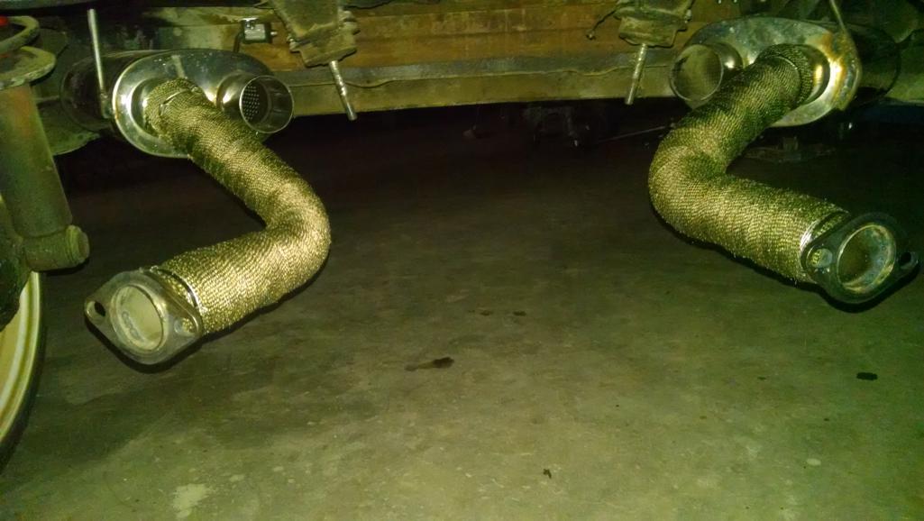

Exhaust hung and wrapped

Porscharu73   Exhaust hung and wrapped   May 18 2014, 05:55 PM
Andyrew   Whats with the open areas of the exhaust? Going to...   May 19 2014, 09:13 AM
Porscharu73   Thought about it maybe later down the road. I am j...   May 29 2014, 12:56 PM
