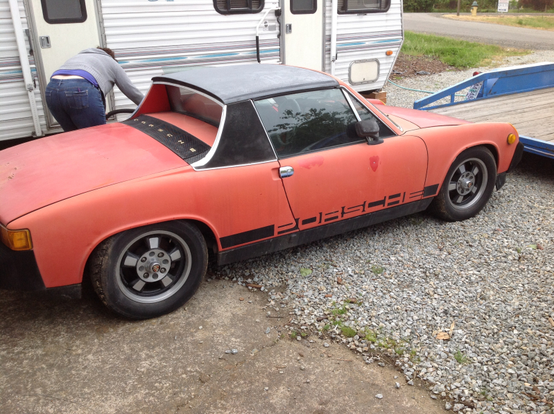

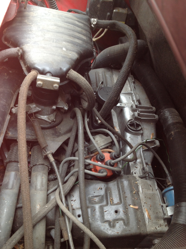

(IMG:http://www.914world.com/bbs2/uploads_offsite/i456.photobucket.com-17371-1400548741.1.jpg)
(IMG:http://www.914world.com/bbs2/uploads_offsite/i456.photobucket.com-17371-1400548741.2.jpg)okay, there are a couple tears. But I'm not shedding any tears.

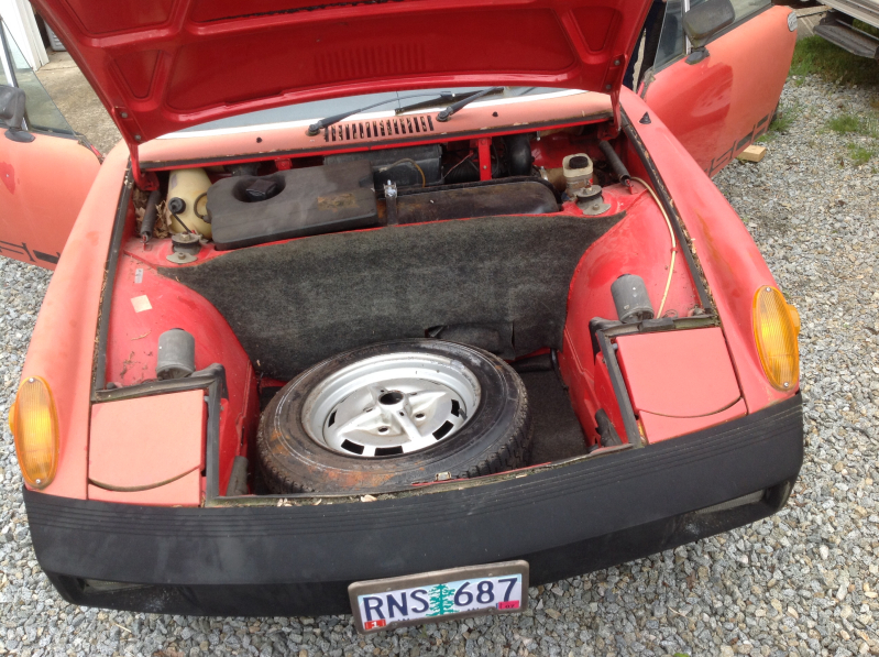

(IMG:http://www.914world.com/bbs2/uploads_offsite/i456.photobucket.com-17371-1400548741.3.jpg)

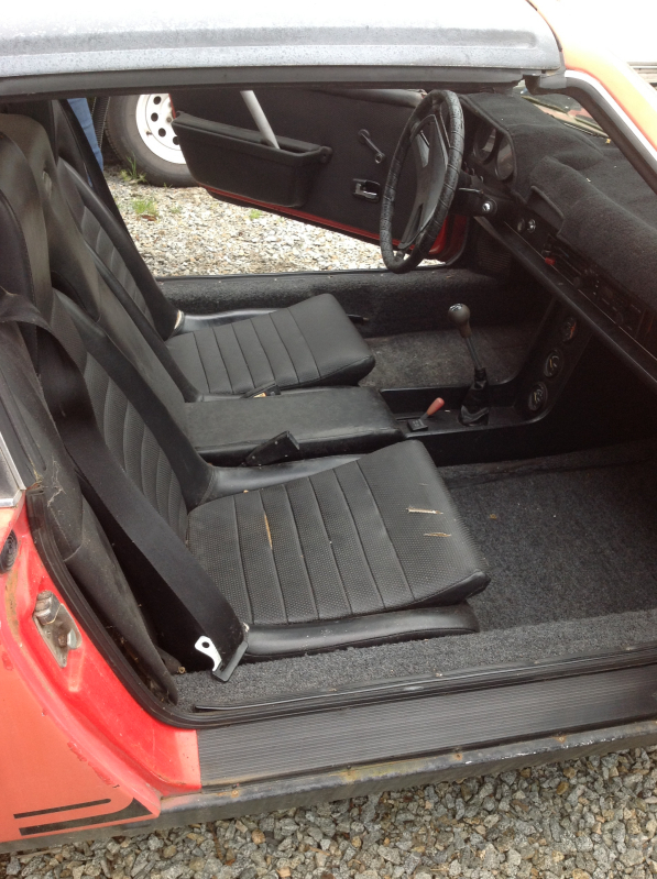

(IMG:http://www.914world.com/bbs2/uploads_offsite/i456.photobucket.com-17371-1400548741.4.jpg)

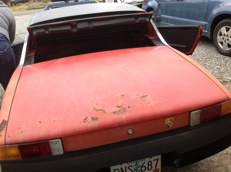

(IMG:http://www.914world.com/bbs2/uploads_offsite/i456.photobucket.com-17371-1400548741.5.jpg)
