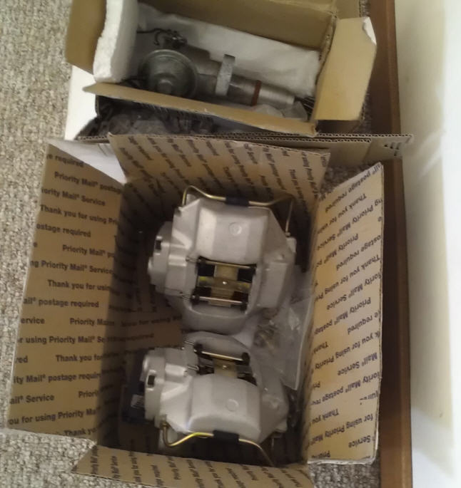

If your still not happy you can call Eric up and get a set off these. (IMG:style_emoticons/default/rolleyes.gif)
