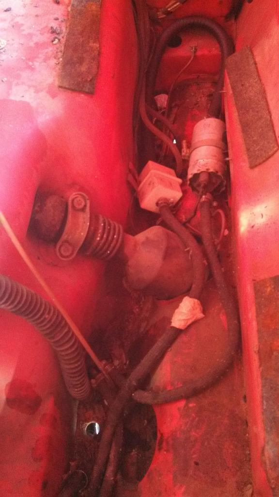

Found the fuel pump. What's the white box?
(IMG:http://www.914world.com/bbs2/uploads_offsite/i456.photobucket.com-17371-1400983319.1.jpg)

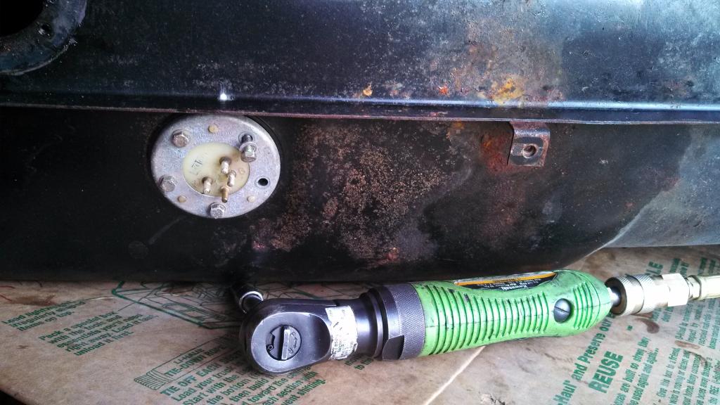

Tank is t and ll be going to radiator shop for cleaning and sealing
(IMG:http://www.914world.com/bbs2/uploads_offsite/i456.photobucket.com-17371-1400983319.2.jpg)

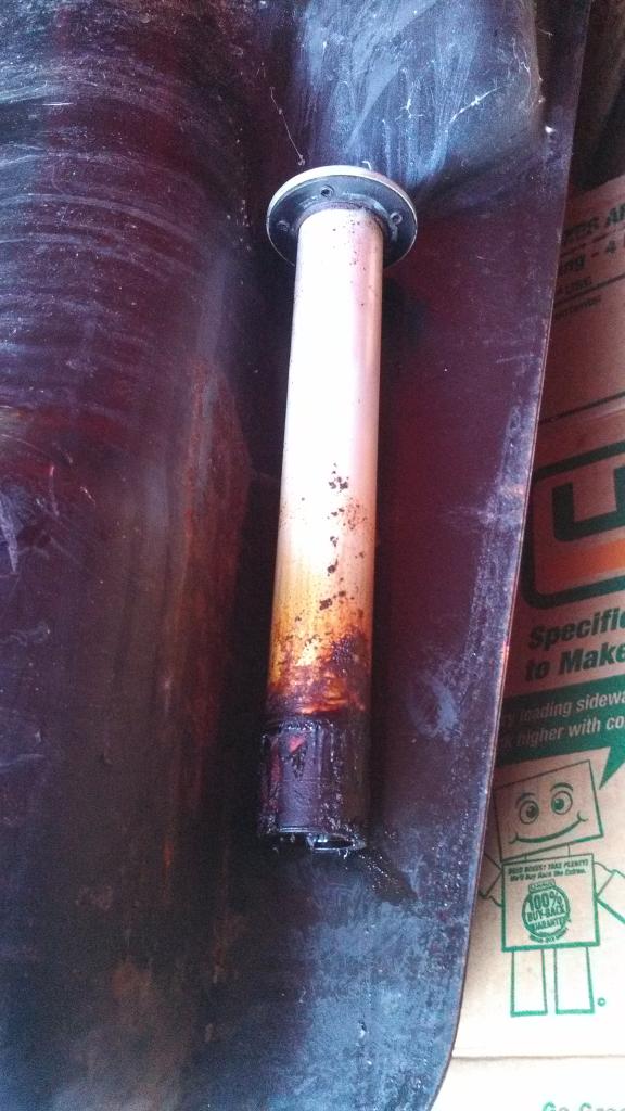

Any thoughts on cleaning the fuel sending unit
(IMG:http://www.914world.com/bbs2/uploads_offsite/i456.photobucket.com-17371-1400983320.3.jpg)

bdstone914   The white box is the fuel filter. That fuel sende...   May 24 2014, 08:11 PM
bdstone914   They do not get change often. You should be able t...   May 24 2014, 08:59 PM
Mikedrevguy   Thought it might be the filter, but, gosh, you thi...   May 24 2014, 08:47 PM

Mikedrevguy   Got fuel line from tank to tunnel out. No real big...   May 26 2014, 07:35 PM
jim_hoyland   Fuel Tank: there is a copper filter under inside t...   May 26 2014, 08:28 PM
Mikedrevguy   $200 to boil, acid wash, and line the tank. ...   May 27 2014, 09:45 PM
Mikedrevguy   Report from radiators shop: inside had some rust s...   May 29 2014, 06:16 AM
jim_hoyland   AA carries two socks (strainers); one for 70-74, a...   May 29 2014, 06:30 PM
Mikedrevguy   Thanks for the lead and the heads up. As far as p...   May 30 2014, 06:17 AM
hndyhrr   that would be the correct one.   May 30 2014, 06:50 AM
jim_hoyland   Thanks for the lead and the heads up. As far as ...   May 30 2014, 08:43 AM
