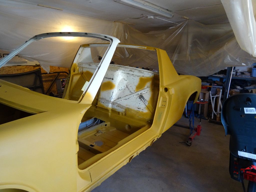

(IMG:http://www.914world.com/bbs2/uploads_offsite/matsgarage.com-15176-1401164593.1.jpg)
Stuffs happening still but as I work out of town during the weeks I only get a fewhours of work done each the weekend. I've finally decided on the colour for
the car to be resprayed in but I'll keep that to myself for now. (IMG:style_emoticons/default/biggrin.gif)
Also scored some nice new stuff like a set of 15x7 Cookie cutters and a set of heat exchangers in very good condition.
Still need to order every rubber part known to mankind from 914rubber and a set of carpets etc... (IMG:style_emoticons/default/type.gif)
Edit: and yes I ran out of primer... (IMG:style_emoticons/default/wink.gif)
