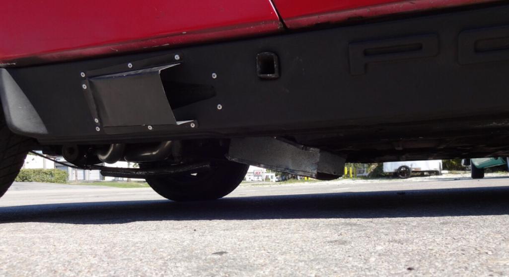

Jetsetsurfshop
post May 27 2014, 10:26 AM
Posts: 815
Joined: 7-April 11
From: Marco Island Florida
Member No.: 12,907
Here you go Chris. Screens are not installed yet in pic, on there now.

Jetsetsurfshop   Duct work   May 27 2014, 09:35 AM
veekry9   Duct work Remarkably similar to the P51 belly s...   May 27 2014, 08:35 PM
Jetsetsurfshop   Tubing   May 27 2014, 09:36 AM
Jetsetsurfshop   To the cooler. There is also a air duct on the low...   May 27 2014, 09:38 AM
Racer Chris   What does the inlet side of the cooler look like?   May 27 2014, 10:15 AM
Jetsetsurfshop   Here you go Chris. Screens are not installed yet i...   May 27 2014, 10:26 AM
Racer Chris   I meant where the ducts end at the face of the coo...   May 27 2014, 10:39 AM
Jetsetsurfshop   I meant where the ducts end at the face of the co...   May 27 2014, 10:58 AM
brant   nice work.... I built something similar for my tr...   May 27 2014, 11:05 AM
Jetsetsurfshop   nice work.... I built something similar for my t...   May 27 2014, 11:23 AM
brant   I think your lack of the 90 turn is only going to ...   May 27 2014, 12:01 PM
Seabird   I was under the impression that the tumbling air u...   May 28 2014, 07:51 AM
Jetsetsurfshop   I was under the impression that the tumbling air ...   May 28 2014, 09:40 AM
Seabird   I was under the impression that the tumbling air...   May 28 2014, 09:41 AM
brant   you have a great bunch of teeners out there... tim...   May 28 2014, 10:26 AM
Jetsetsurfshop   New bumper exit. I think I've been building up...   Jun 15 2014, 09:02 AM
